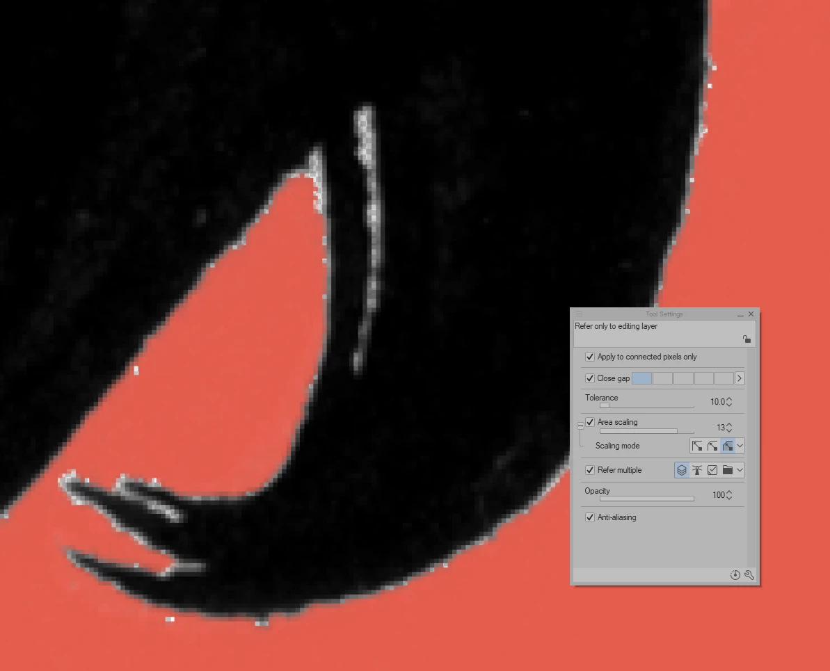

    Clip Studio Paint:

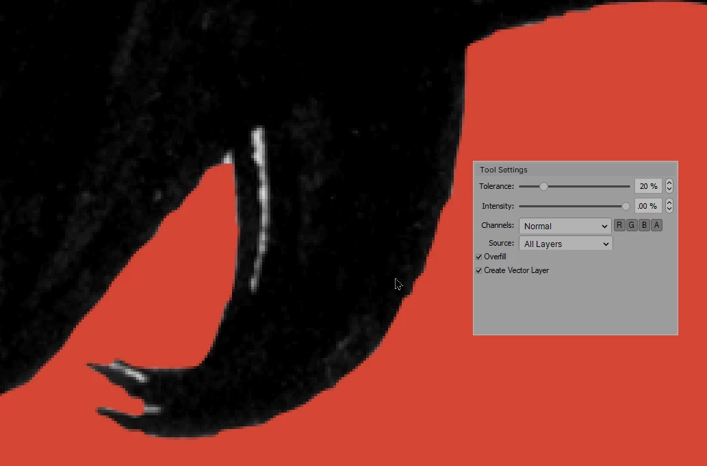

    PhotoLine has a neat vector fill option, but also struggles with the fill layer overlaid on top of the line art. It looks okay, but not great:

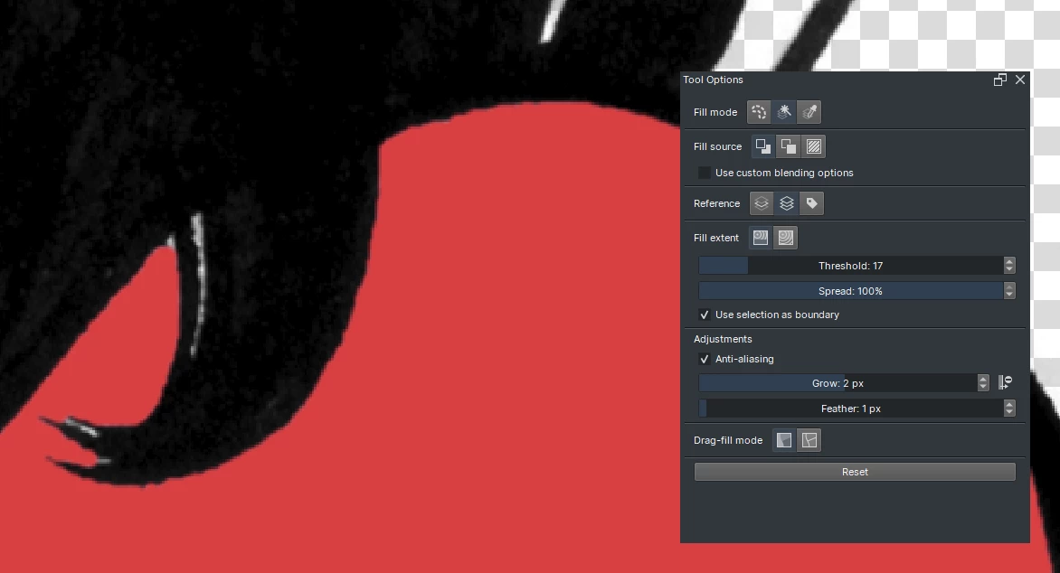

    Of all fill tools, Krita does an acceptable job (it does have the most feature-rich fill tool for this type of job), but still requires manual cleanup:

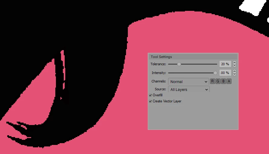

    That is why comic artists and illustrators (including myself) convert the anti-aliased line work to aliased 1bit ones before colouring:
    The threshold adjustment will only work on a non-transparent background, btw.

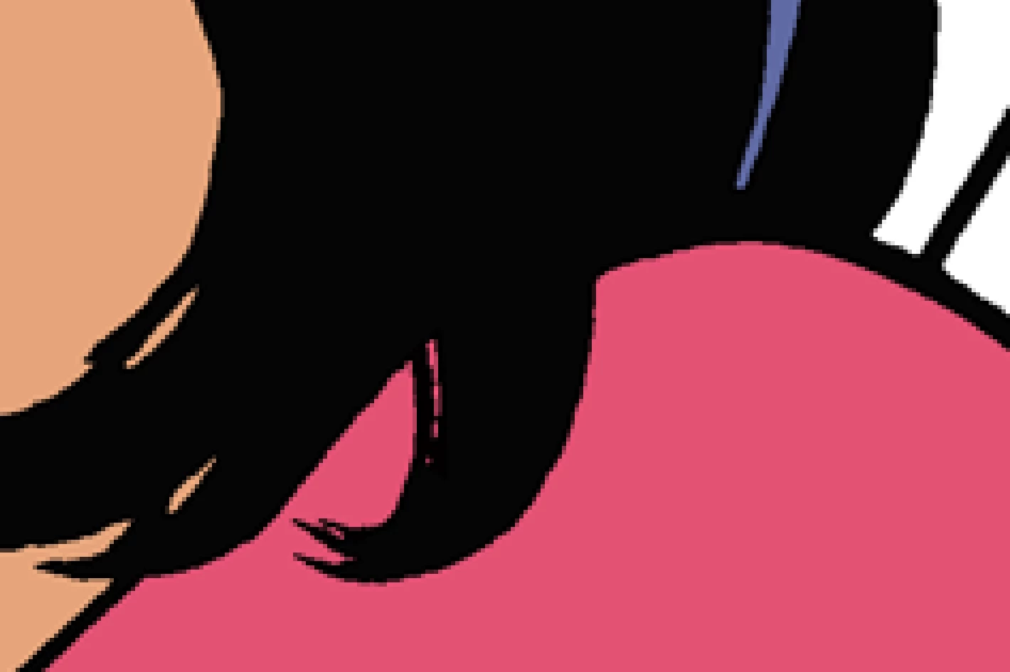

    Now it becomes possible to add colour fill layers under the line art and it is becomes easy to create fills that no longer produce visual outlines:
    This works really well for high resolution print output. But also for web or screen output, since we can always scale down - and when we do so the final screen version will have beautiful anti-aliased lines.
    This means your art should be drawn on a high resolution canvas, even if you intend it to be prepared for lower resolution art (web, etc.) later. Ideally at a minimum of [required print size] x 600 - 800dpi.
    Then when it is time to create a digital screen version: scale down the final art to the required screen size. When we do so, the 1bit black line art will be anti-aliased and look just fine for screen work as well:
