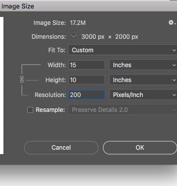

To get a visually  interactive idea, make a 3000 x 2000 pixel image and then go to Image > Image Size. Uncheck Resample.
Then starting at 200 and going to 360 ppi resolution, you will see the image size on paper shrink. PPI is the instructions to the printer at what size on paper you want that image to be. Although depending on the printer, 200-360 PPI is the reasonable range for a good printout. Pretty simple math, 3000 px/200 PPI = 15 inches.  PPI is flexible for your needs. It is not a constant number.
