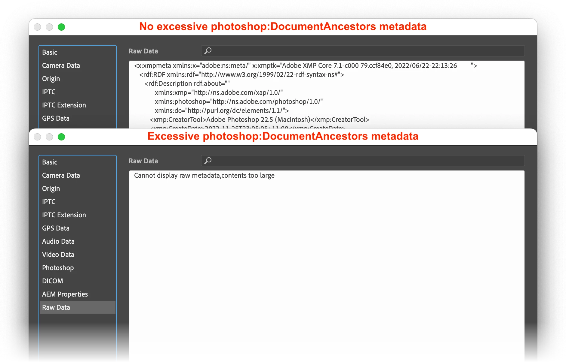

Reuse of templates is a clue... Go to File > File Info and then the Raw Data tab.
Is there a single line message that there is too much metadata to display?
Or do you see the standard XMP metadata entries?

When I open the File Info all the fields are empty. I know, the reuse of the PSD file is the clue. But what?

@Alex782012 – I asked for the Raw Data tab, not the other tabs such as Basic. Illustrated below:
Excess photoshop:DocumentAncestors metadata can add up, however, this may be only part of the answer even if it is present.
