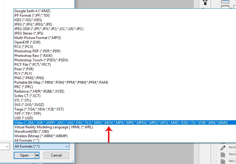

Has anyone else noticed that photoshop cc 2017 won't open QuicktTime MOV files without QuickTime being installed on windows 10 or is it just my machine.

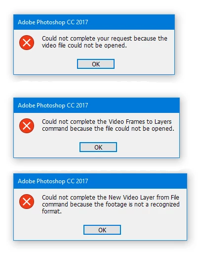

I wasn't able to open, import video frames to layers or new video layer from file any of my MOV files on a windows 10 x64 with photoshop cc 2017.
In the File>Open dialog under Video, MOV is listed as supported.
Got the error messages as below
So after installing just the essential quicktime components (not quicktime player) MOV files work fine in photoshop cc 2017.
