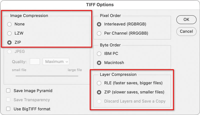

    If the concern is large file size, some things to think about…
    It matters how you compress the TIFF file:
    • TIFF uncompressed is potentially larger than PSD, which does use some compression.
    • TIFF with LZW compression can save some space, and has been common in prepress workflows for many years.
    • TIFF with ZIP compression can potentially save the most space while being lossless. Two issues with TIFF+ZIP are although it should be fine, there may be some print service providers running equipment old enough that it doesn't properly support TIFF with ZIP compression. Also, TIFF+ZIP files can take a very long time to save.
    For InDesign, one reason to use PSD over TIFF is if you need to control image layer visibility from the InDesign document. Then you’d place a layered PSD file. If that’s not needed, a flattened TIFF is fine.
    And I think it was already mentioned that TIFF/PSD at 8 bits per channel will be a much smaller file than 16 bits per channel. It’s OK to keep the layered original as 16 bits/channel, but if the flattened copies of images you’re placing for prepress are the final versions of images (they won’t be edited again), they will be just fine as 8 bits/channel.

    A PSD and a TIFF will have exactly the same size uncompressed. If you use compression, there might be differences depending on compression algorithm. Be aware that LZW compression on 16 bit files will usually increase the file size, not reduce it. It was made for 8 bit data.
    Also be aware that compression dramatically increases open/save times, sometimes 5x to 7x. Layered files are especially affected. I never use compression, in any form, for this reason.
