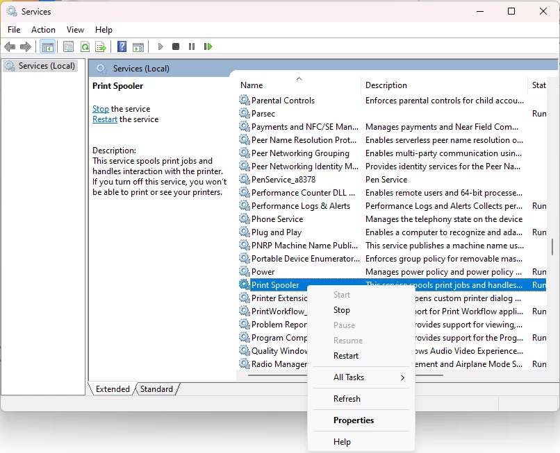

    What worked for me is by restarting the Print Spooler on Services.
    1. Windows Start
    2. Search "Services"
    3. Scroll down to "Print Spooler"
    4. Right click on the name
    5. Press "Restart"
    1. Windows Start
    5. Press "Restart"

    This fixed my problem, thanks for the suggestion!!

    This is old, but it actually works! hanks BOB

    I was getting this message periodically.  I ran the troubleshooter on my printer and for some reason the print spooler was not starting automatically.  Troubleshooter "fixed" the problem and I was able to print.
