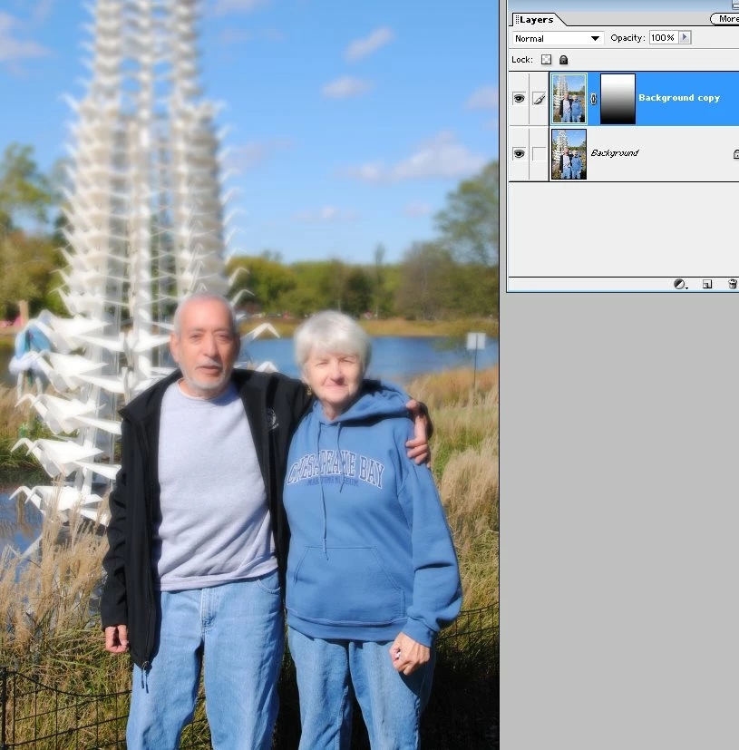

    April 2, 2018
    Perhaps this example is what you are trying to do using a gradient. I started with this picture:
    Duplicated the layer and added a Gaussian blur.
    Added a layer mask.
    Activated Gradient Tool with the linear Black,White option.
    Drew a gradient from bottom of picture to about 1/4 from the top. This created no blur at the bottom gradually blurring to the top.

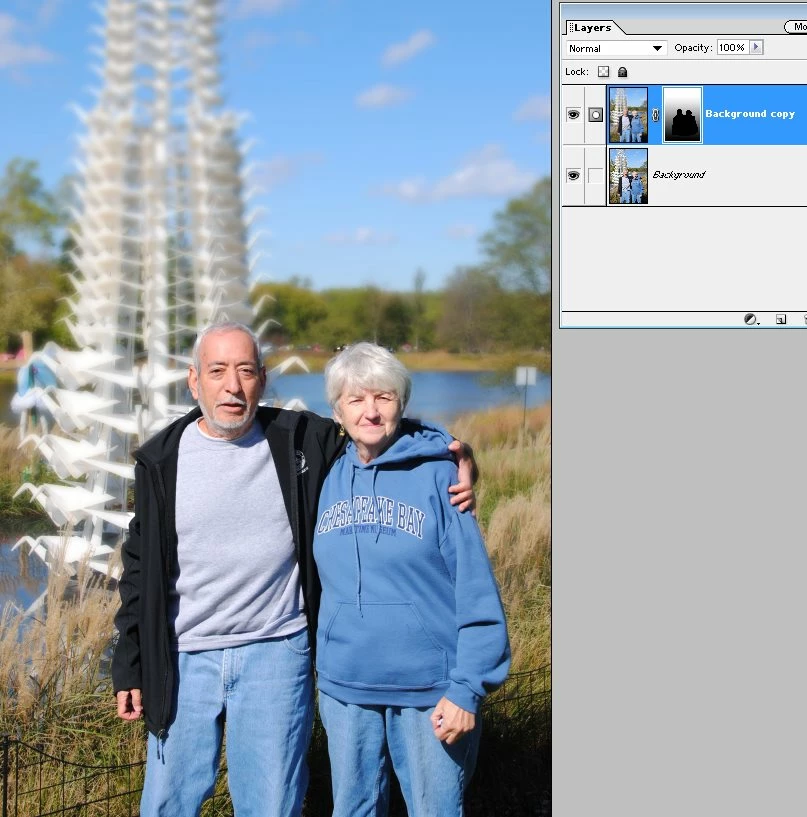

    Note that portions of the couple also blurred. To correct this I painted black on the mask using a hard black brush. I could also have selected the couple using the various selection tools and filled the selection with black:
