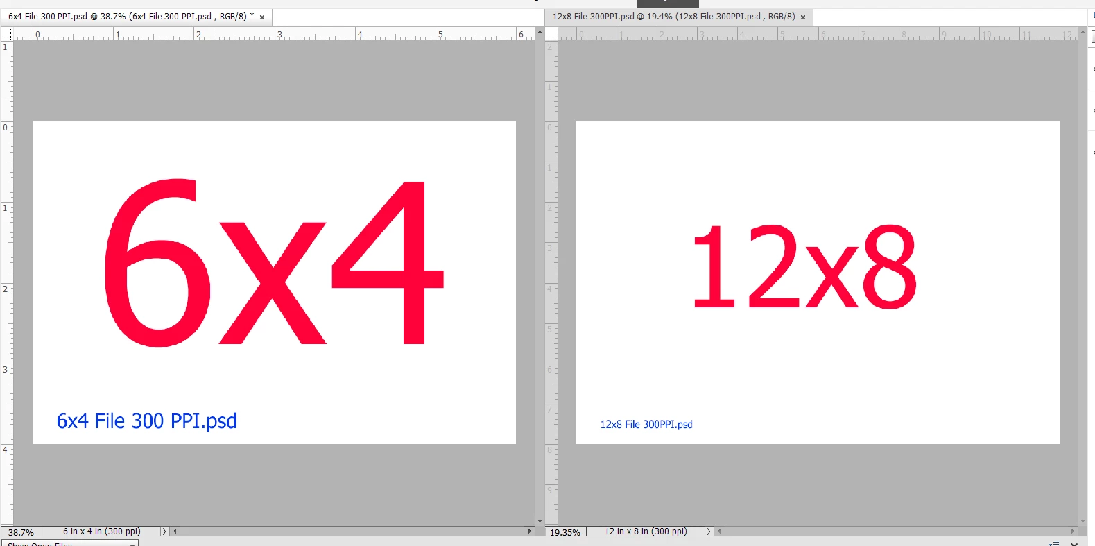

As you can see from the following screenshot, the relative size of the caption depends on the resolution (number of pixels) in the image.  I have created two blank files, one 6x4 inches and the other 12x8 inches.  Both files are 300 pixels per inch.  I added the red text layer to show the size of the image.  The text was created with the same size font (200pt).  I then processed the files (as you have correctly done) and here is the result:
As you can see, the higher resolution file shows the text in a relatively smaller size.    You have different resolution files which results in different size text.

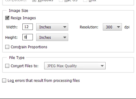

So, next, I took the same files and used the Process Multiple Files dialog to resize the images to the higher resolution of 12x8:

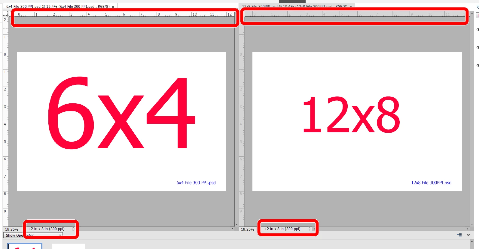

Here is the result of adding the File name to the resized files:
As you can see, the files now have the same size/resolution and the caption text is also the same size for both images.
Hope this helps you understand the problem and perhaps provides you with a solution to your different resolution files.

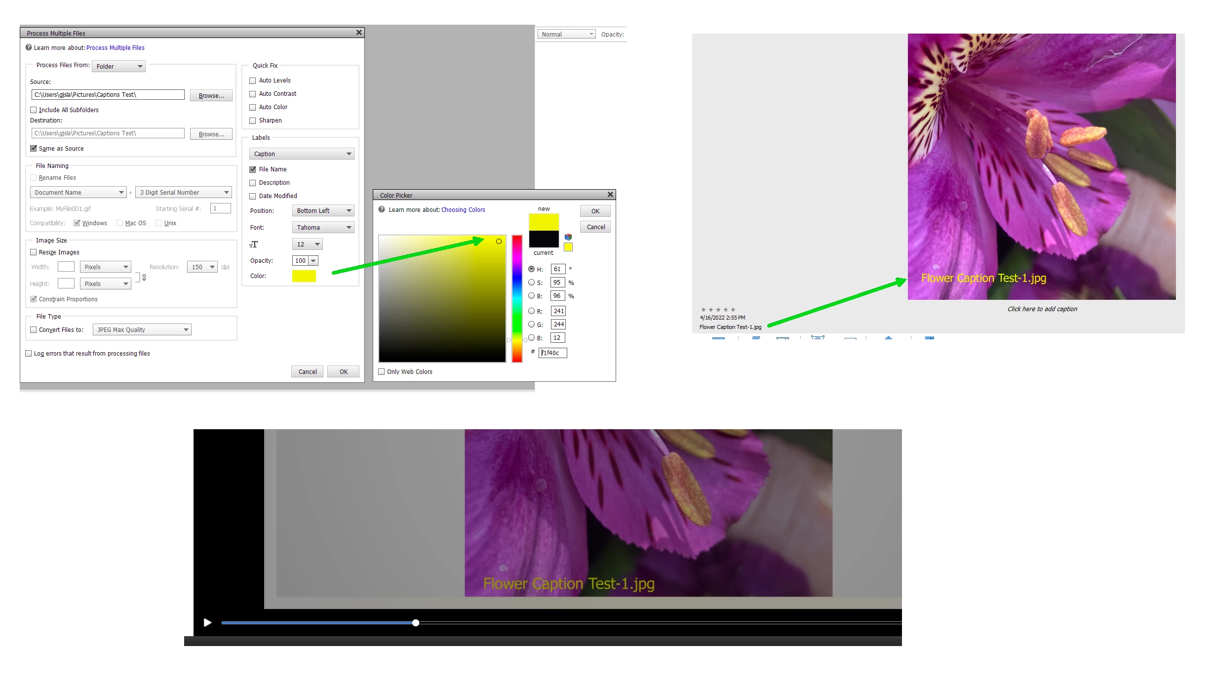

@ROGER25366188xtps, I don't know which post you are responding to.  My screenshots are taken from Elements 2022.  So, I don't understand what you mean when you say that "you have been told my trial version of PSE 2022  . . .  is not good enough."  Good enough for what?  Have you tried Barbara's "simple solution" with Elements 2022.  I have.  And it works  -  just like it has worked in every version of Elements since Barbara pointed it out.
If you are having difficulty with the necessary steps, let us know where the problem exists and we can try to help you with more step-by-step instructions.  At this point, my only guess is that you have not realized that the solution requires you to go to the Editor (not the Organizer) to access the Process Multiple Files dialog.

Aug 13, 2022 7:59 PM UTC
Just so I completely understand your request:
You have renamed your files with descriptive words instead of the numbers generally given to a file by the camera.  You want those descriptive file names to appear on the photos that you place in a slideshow.
If so, Barbara's solution has worked with every version of Elements since at least version 10 which is the oldest version on my computer.  I am assuming it will work with Windows 11 but I have not upgraded from Windows 10.
In my screenshot, I have changed the color of the text that appears on the image which is displayed in the Organizer thumbnail and will appear in the Organizer's Slideshow feature (depending on what theme you use).
In my testing, I found that you may need to experiment with the size and color of the caption that will appear on the photo.  The size probably depends on the resolution of the photo.  You should therefore only work with copies of the photos before using the Editor's Process Multiple Files feature.  To make my test, I used the Organizer's Export Files as Copies feature to place the files in a separate folder.  Once the files have been processed, you can then import them into the catalog to use for an Organizer slideshow.
