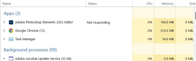

Adobe Elements 2022 will not close properly without using task manager

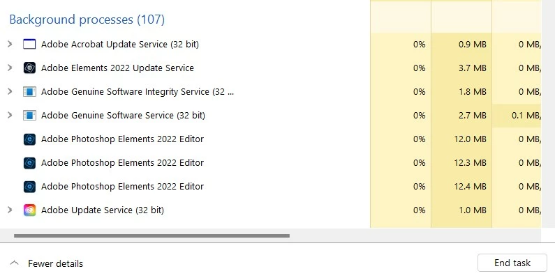

Recently installed Adobe Elements 2022 on a new windows 11 PC Computer. I can normally open the Editor and the Organizer one or two times. If I try to open either one again, the program appears to try to open, but nothing happens. If I look in the Task Manager, at times either or both Elements and Organizer is still shown still in the Apps section with "not responding" shown next to them.  I have to highlight and "end task" to shut it down. After doing this, the program will open again one or two times then repeat the process. Other times, the program will attempt to open, but nothing happens. I look in Task Manager and the program is shown running in the backgraound processes area. Each time I attempt to open one of the programs (elements or organizer), a new process is started, but the program will not open. I must use the task manager to end each task, or restart the computer to clear the processes.
