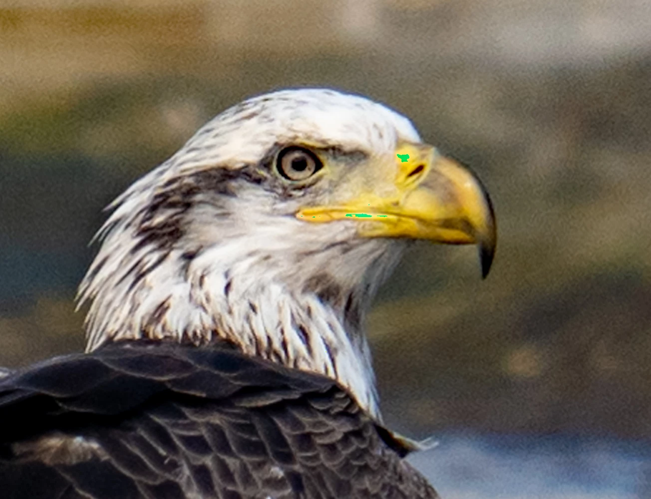

I am having an issue with the haze removal function when editing a raw image.  If there is any yellow in the subject, it often turns it pea green during haze removal.  If I save the image as a JPG without using haze removal, then go back and remove haze from the JPG, it leave the colors alone.
Also, in the raw image, when I select remove haze and look a the preview, the green is not there.  But when I hit "OK" to make the change, it puts the green in there.
I shoot a lot of the Blue Angels as well as bald eagles, and both have yellow in them - so this is really slowing me down.
I'll attach a couple of tight (grainy) crops just to show what I'm talking about.

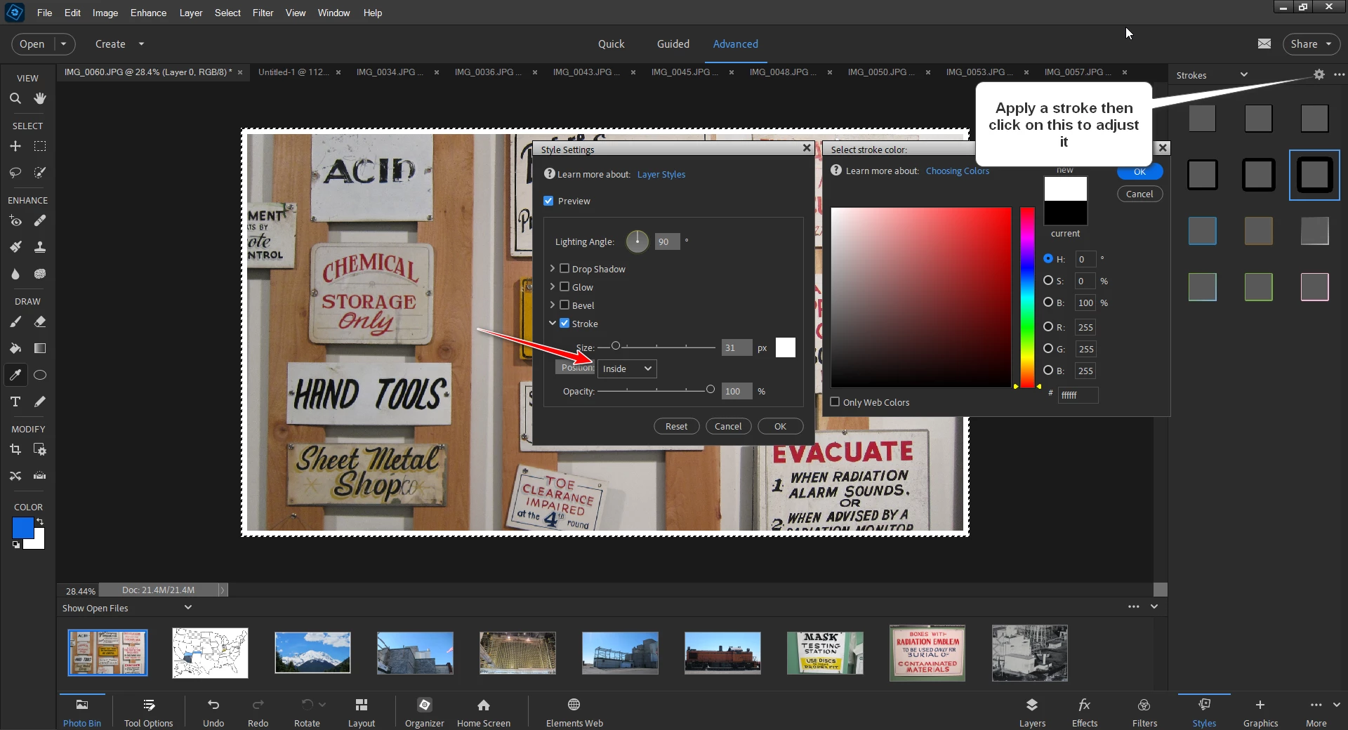

Below is a screenshot of the entire program.   Please post a screenshot or two of when it happens.
