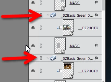

    A picture is worth a thousand words.    Unfortunately, I can't determine why you are having problems using the arrange tool from the options or context menu.  Each of your frames seems to be grouped and should move together and be available for arranging using all of the tool options.  I can't figure out why the Arrange tool would work from the main menu but not from the context menu or Move tool options.  Perhaps in your experimenting, one of your groups became unlinked.
    Does the Move tool option work, if you first select a group name in the layers panel?
    I don't often work with frames, so I think we have reached the limits of my knowledge on the subject.  Hopefully, somebody with more experience than me can come up with a simple solution.

    Greg, you've given me some food for thought with the possibility that I've inadvertently unlinked some groups. I'll look into that.
    May I trouble you for one more question?  I'm unfamiliar with your terminology above: "first select a group name in the layers panel?" Duh, what's a group name?  Is it the layer (in this case the frame layer) with the symbol that indicates that there are multiple linked layers?
    Yes, that's what I was referring to.  Your term (frame layer) is probably more correct but I wanted to distinguish it from the "frame" layer that is included in the group.
    In working with you on this problem, I found that if you double-click on the photo within the frame, the group seems to become ungrouped so that the image can be moved or resized.  The same is true even if the layers are linked.  So I can see how easy it is to ungroup a frame inadvertently.
