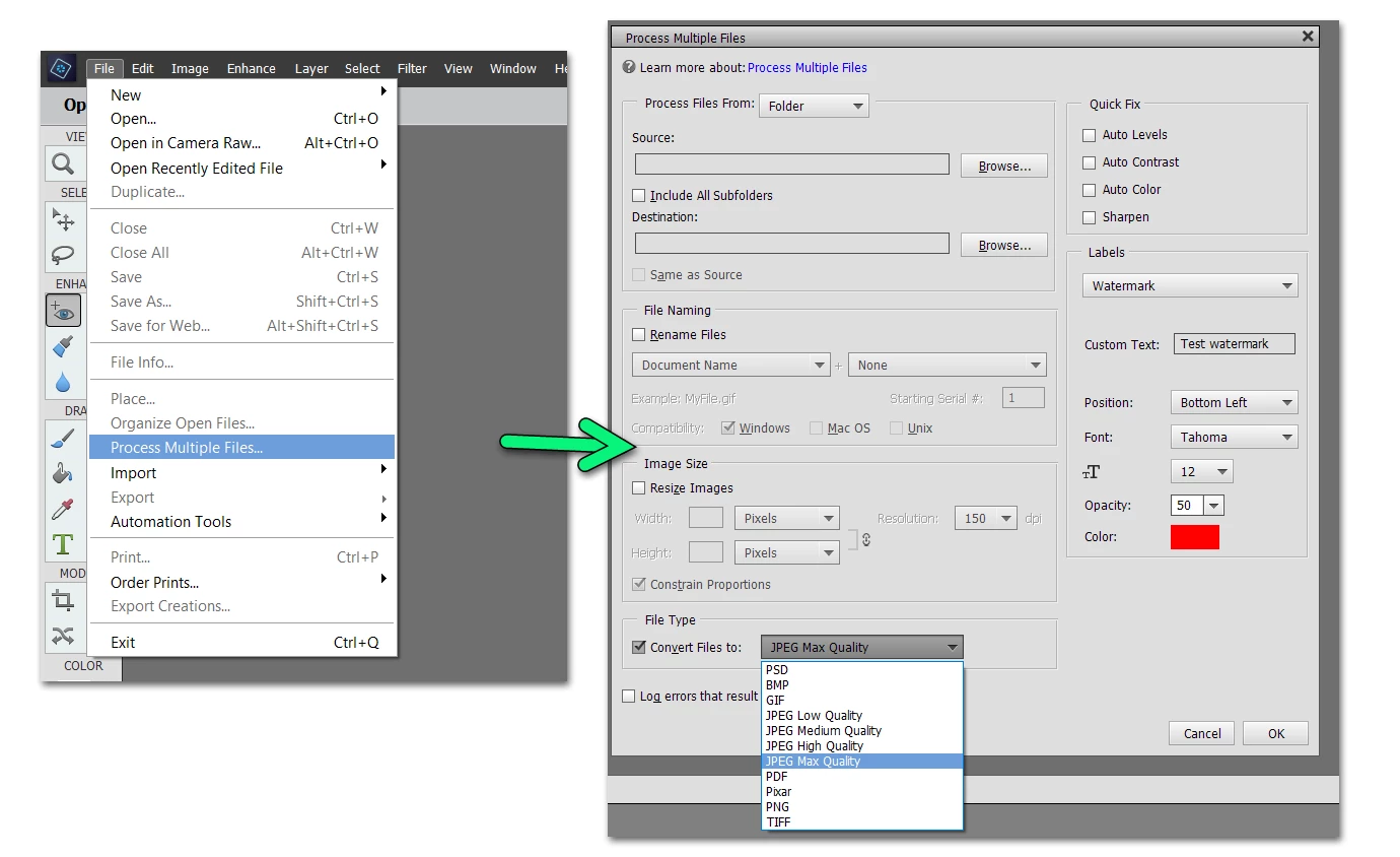

You need to be in Expert mode to activate the Process Multiple Files... menu option.

The only suggestion I can make is to use the Editor's File>Process Multiple Files to rename the files and then import the files into your catalog.
I don't know whether you can preserve any tagging using this method.  Do some experiments on a single folder to find out. And if the tags are preserved, I don't know whether the audio caption will carry over to the renamed file.  Alternatively, maybe use the Process Multiple Files dialog to change the quality and/or format of the files.   For example, change the quaility to one of the jpeg presets or perhaps change the format to Tiff.  I expect that this will lose any tagging information, but you should also lose the bad reference to an audio caption.

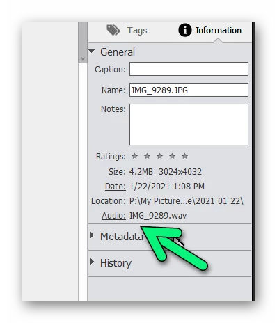

I just tried creating some audio captions and then deleting the .wav files via Windows Explorer.   The Organizer database was obviously unaware that I had deleted the caption .wav file and still showed the speaker icon.  The wav file was also still listed in the Info. Panel.

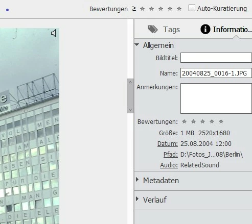

JuppHO
JuppHOAuthor
Mar 5, 2021 12:02 PM UTC
 So sieht das bei mir aus.
Ich nutze WIN10 und PSE2019.
Die Audiodateien sind wohl versehentlich beim Einscannen entstanden. Es wird zwar angezeigt "RelatedSound" es ist jedoch keinSound oder ähnliches hinterlegt. Ich hätte geren die Dateien gelöscht, aber jeweils einzeln bei jedem Foto ist sehr mühsam. Gibt es einen Weg bei allen Fotos die Audioanzeige zu löschen?
