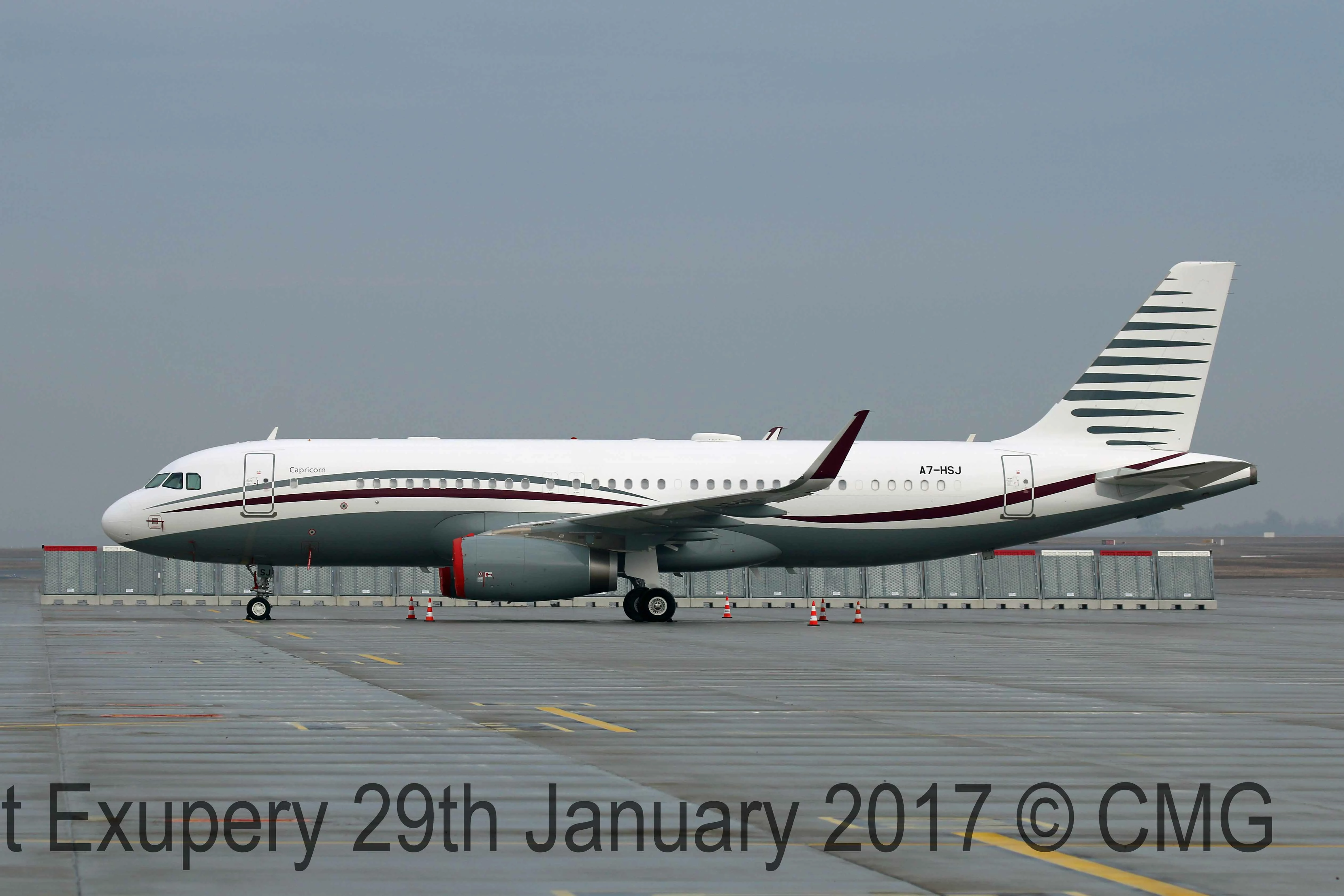

    This is what i get with the font size 6 selected, this image is 5034 x 3362 pixels.

    campbellm11776533
    January 30, 2017
    Yeah the same relevant sizes taken with my canon 70D, I dont resize just crop if I need to prior to batch watermarking, the 3 images in question are 5034 x 3362,  4936 x 3290 and 5032 x 3355 pixels.
