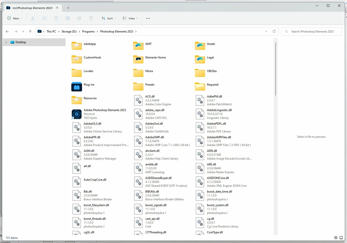

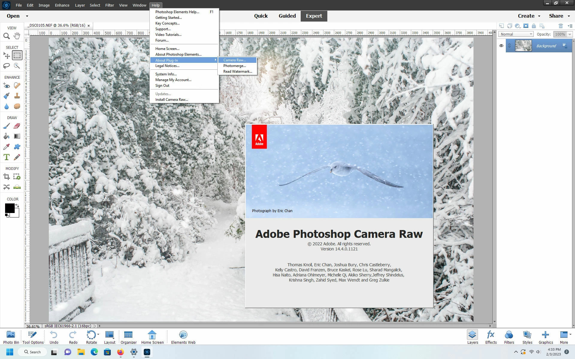

I just did a test install of photoshop elements 2023 with windows 11 and installed pse 2023 on a "D" drive.
Then i installed camera raw from within the pse 2023 editor and chose the Default location which would be the "C" drive.
It seems to have installed on C drive and works fine in pse 2023.

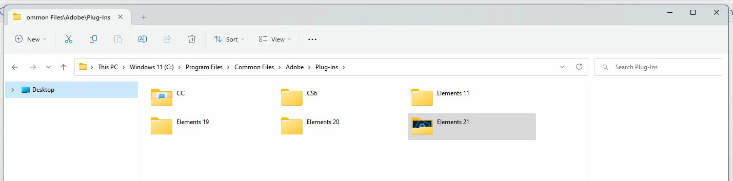

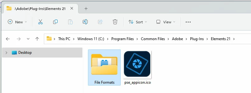

If you go to
C:\Program Files\Common Files\Adobe\Plug-Ins
is there a
Elements 21 folder with a File Formats folder inside?
