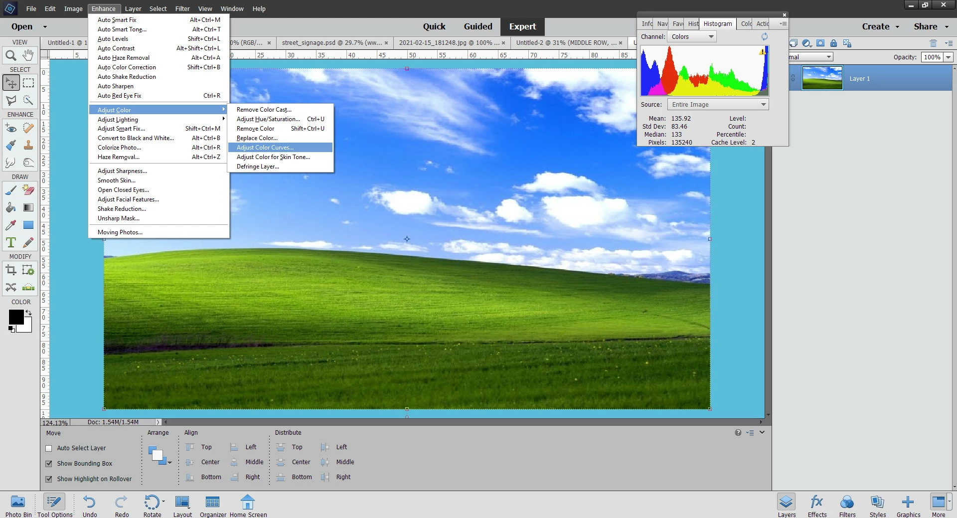

This si the closest you can get in PSE.....
