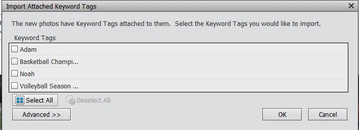

"I made an attempt with a new catalog. I imported a small sample of the photos, but I cannot find the tags. Is there a dedicated way how to import also the tags?"
Normally, if you import files that have already been tagged e.g. in another catalog, you will get a dialog that asks you whether you want to import the tags.  If you already have tags in the catalog, you  are given the opportunity to map the tags to the existing hierarchy (using the Advanced dialog).  Unfortunately, People, Places, Events tags become ordinary keyword tags.  However, it is a fairly easy process to create a new person tag and copy the keyword tags to the People tag list.

If you have a corrupt catalog, I don't think there's much you can do without help from Adobe.  However, if you create a new catalog and import the same tagged files into them, you should be given the opportunity to also import the keyword tags with the media files.  This will save you the job of tagging them again.

Thanks for your hint with creating a new catalog and importing the photos. Worth to give it a try!
