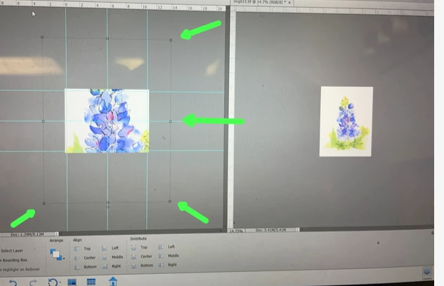

Greg_S.
Jun 7, 2023 7:06 PM UTC
As @hatstead mentioned, your aspect ratios won't fit.  The file on the left has a landscape orientation.  The one you are trying to fit into it is a portrait ratio.  You can use the size handles shown in my screenshot to resize the painting layer.  But it will never fit into the space without something being cropped out or blank space showing.

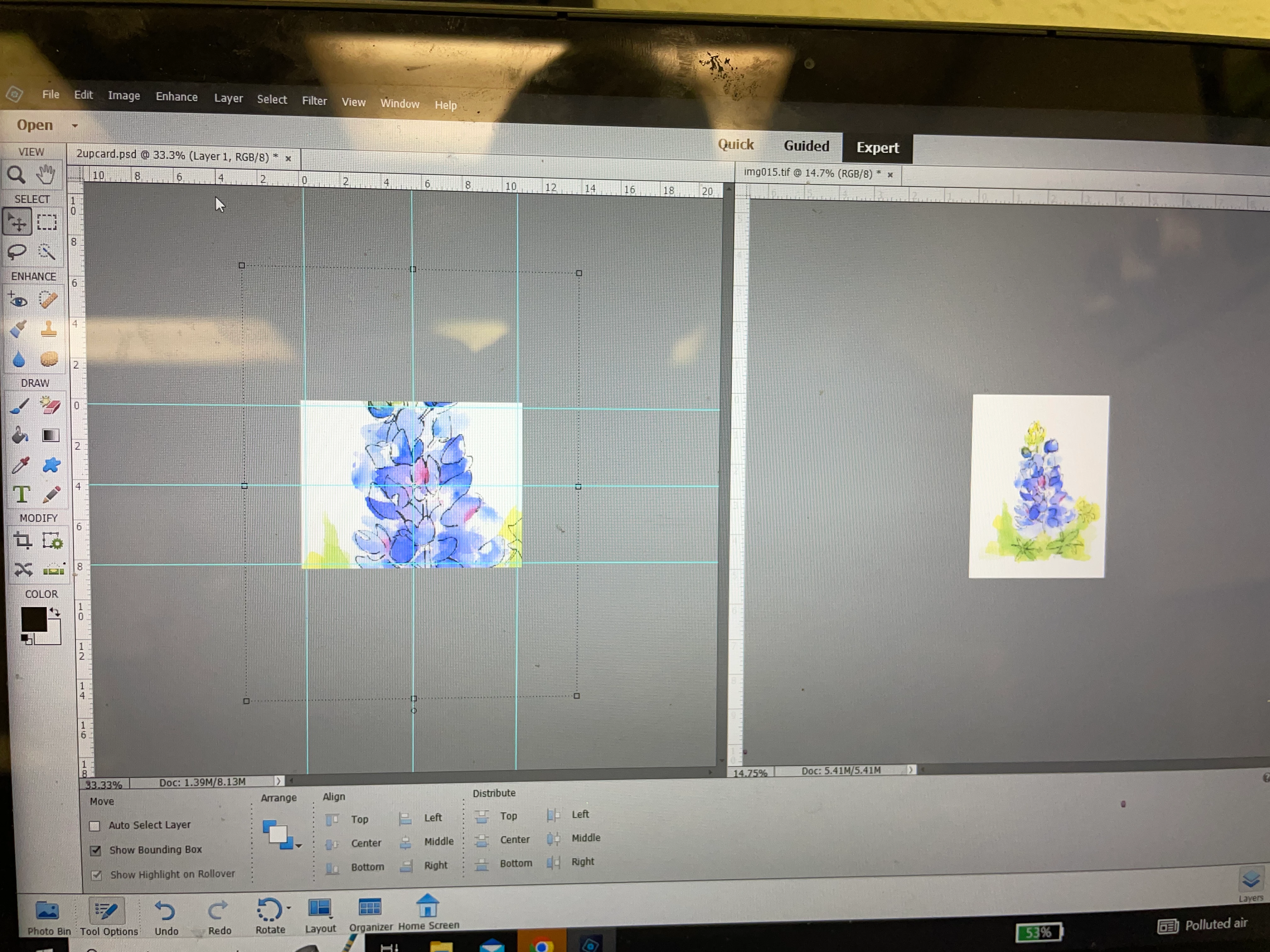

Cindy, your screenshot shows that the files are at different zoom magnifications. The one on the left is being displayed at 100%, and the one on the right is at 14.75%.   If you zoom each file to the same magnification, I think you will find that they are the same size images.
Jun 7, 2023 6:55 PM UTC
I reduced the left side alot and you can see in this photo, the middle part of the artwork is coving the entire template!
