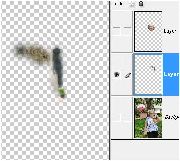

    To correct this I added a blank layer above the original Background layer.
    Activated the Clone tool with the "Use all Layers" option.
    Cloned areas adjacent to the original sticking out portions to cover those portions.
    For the top of her hair I cloned some of the tree. On the right side I cloned some of the bush and house shutters.
    Here I show just the clone layer so you can see what's going on:
