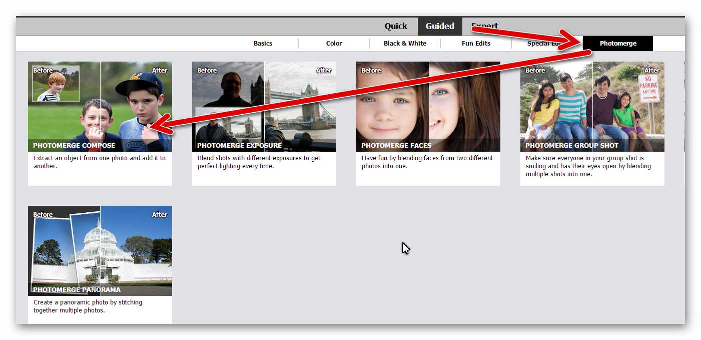

If you want something like this:
Try the Guided Edit>Photomerge>Photomerge Compose tool:
