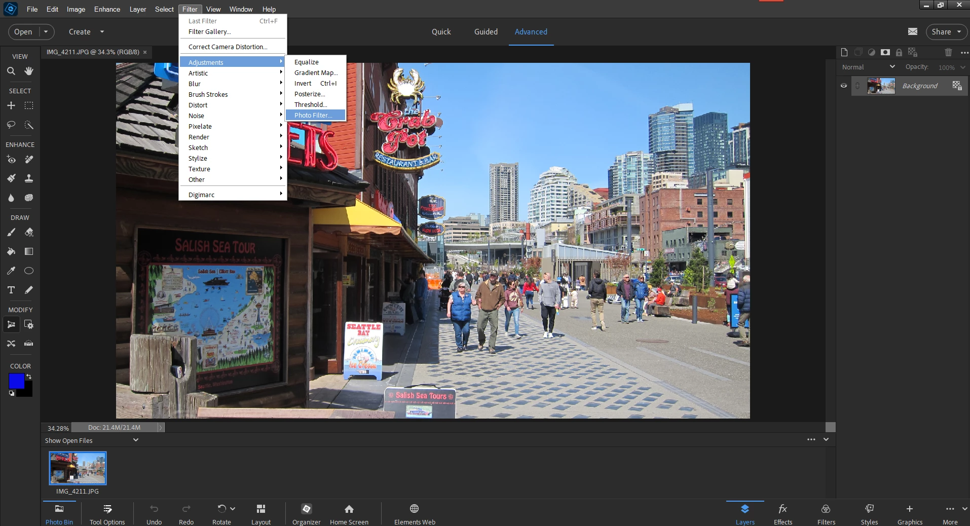

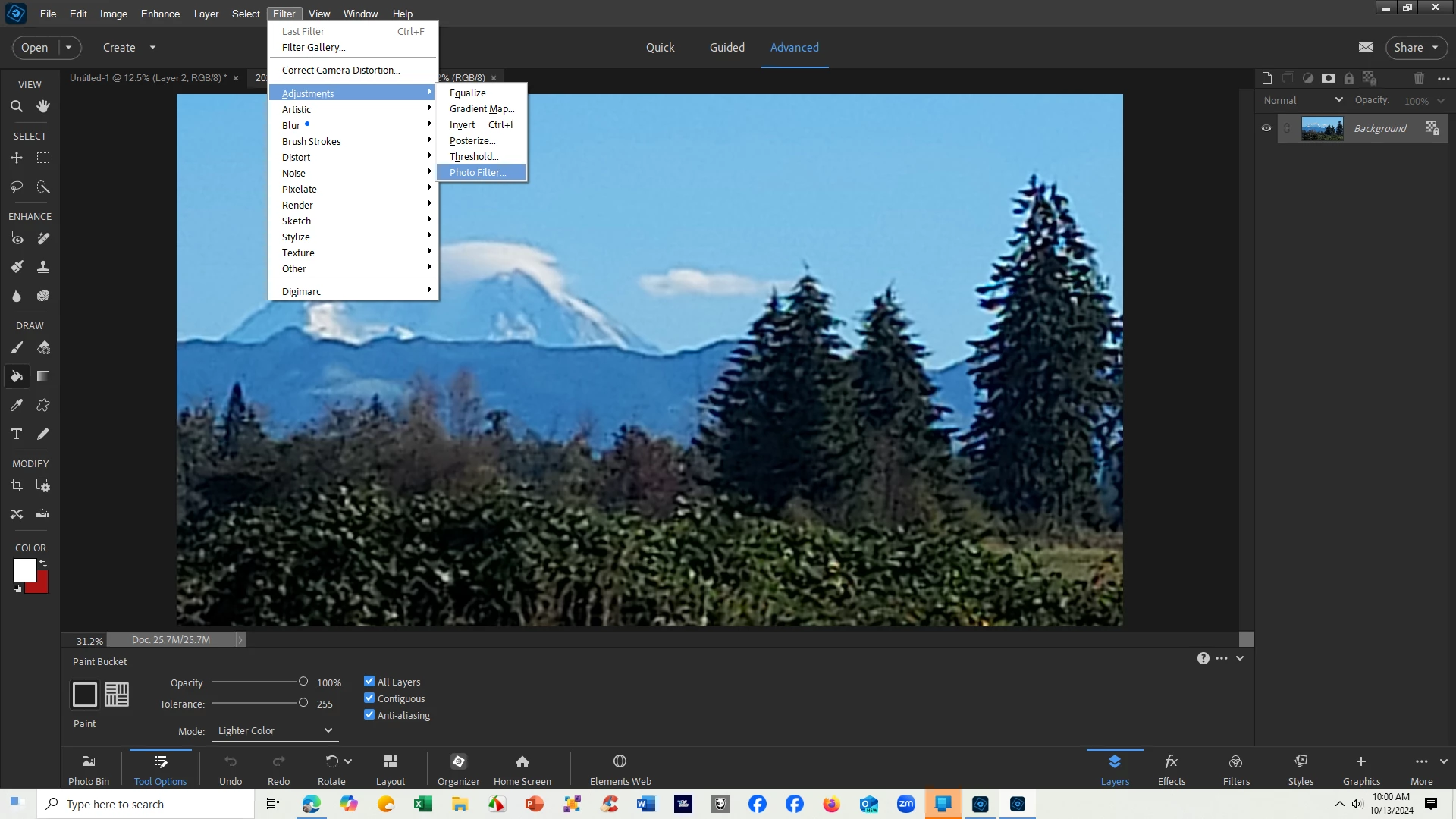

By far, the easiest method.
May 24, 2025 1:51 PM UTC
i didn't know about that filter - yes much easier, thanks

May 24, 2025 5:07 PM UTC
It'as often over looked.  A nice way to alter the tint of older photos that have "turned orange" and the dyes in colotr photos fade.

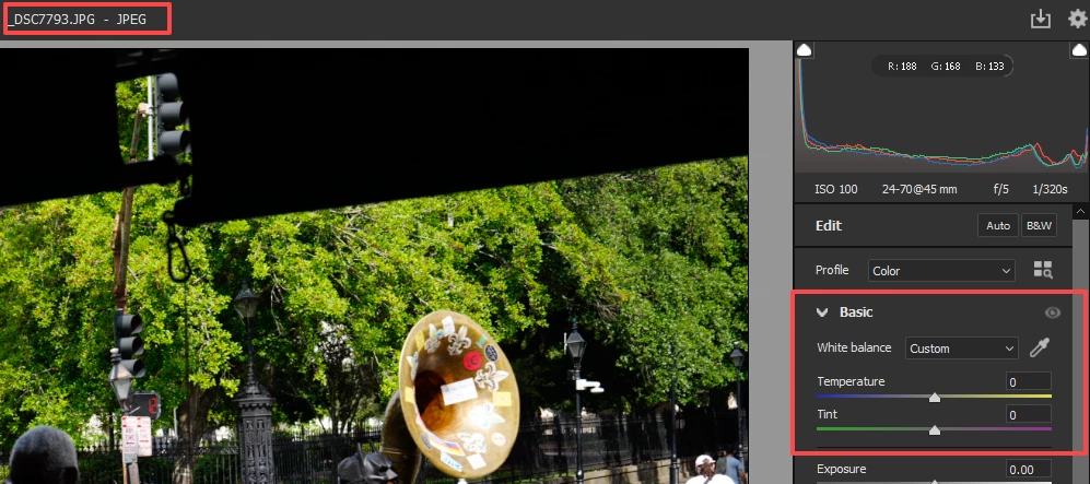

Use the File>Open in Camera Raw command.  This will allow you to open any format of image into the Camera Raw editor which has a Temparature slider under the Basic panel:
If you have not already done so, you will need to install the Camera Raw Editor under the Help menu.  Also, once you have completed your edit, you need to click on the Open button in the lower right corner of the Camera Raw Editor.  This will open the image in the regular Editor and you can then make further edits or save the file as you would normally.
Oct 15, 2024 2:08 PM UTC
thank you Greg  - i'll give that a try. I'm surprised that they don't have a simple temperature slider inside the program without having to download extra software
