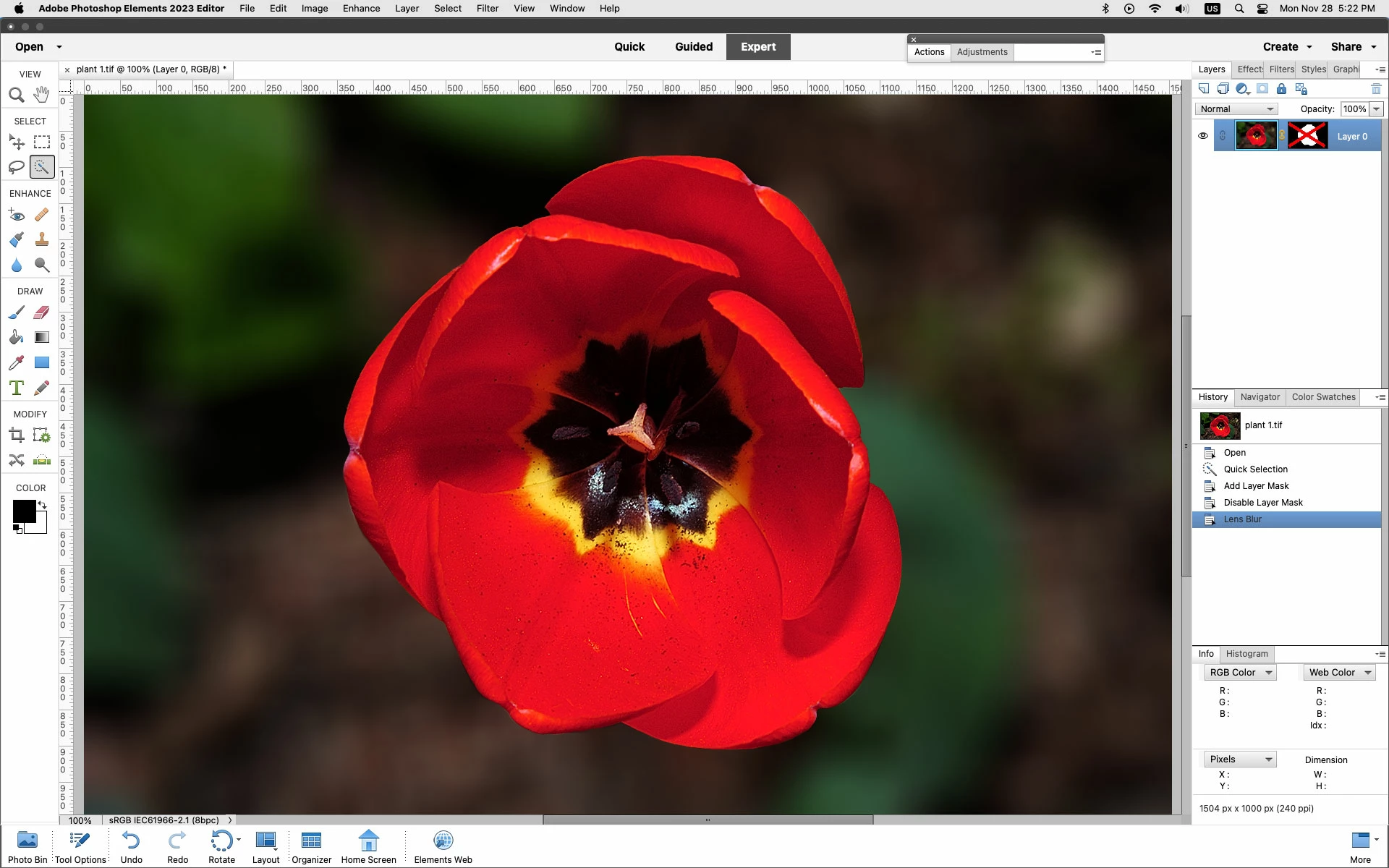

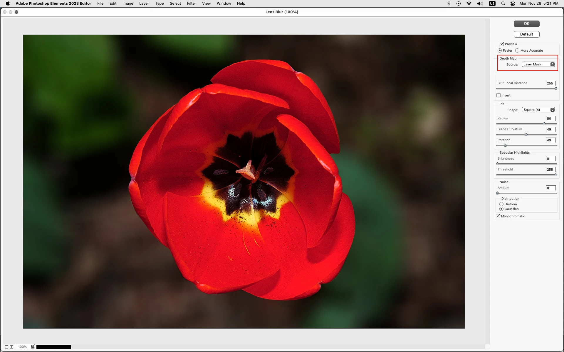

Instead of a gradient you could use Filter>Blur>Lens Blur and select Layer Mask as the Depth Map Source.
https://helpx.adobe.com/photoshop/using/adjusting-image-sharpness-blur.html
Like this
1. Click on the pixel layer to make sure it's selected and not the layer mask
2. Shift click on the layer mask to disable it
3. Go to Filter>Blur>Lens Blur and under Depth Map Source select Layer Mask, then adjust the sliders as desired for a      blurred background
