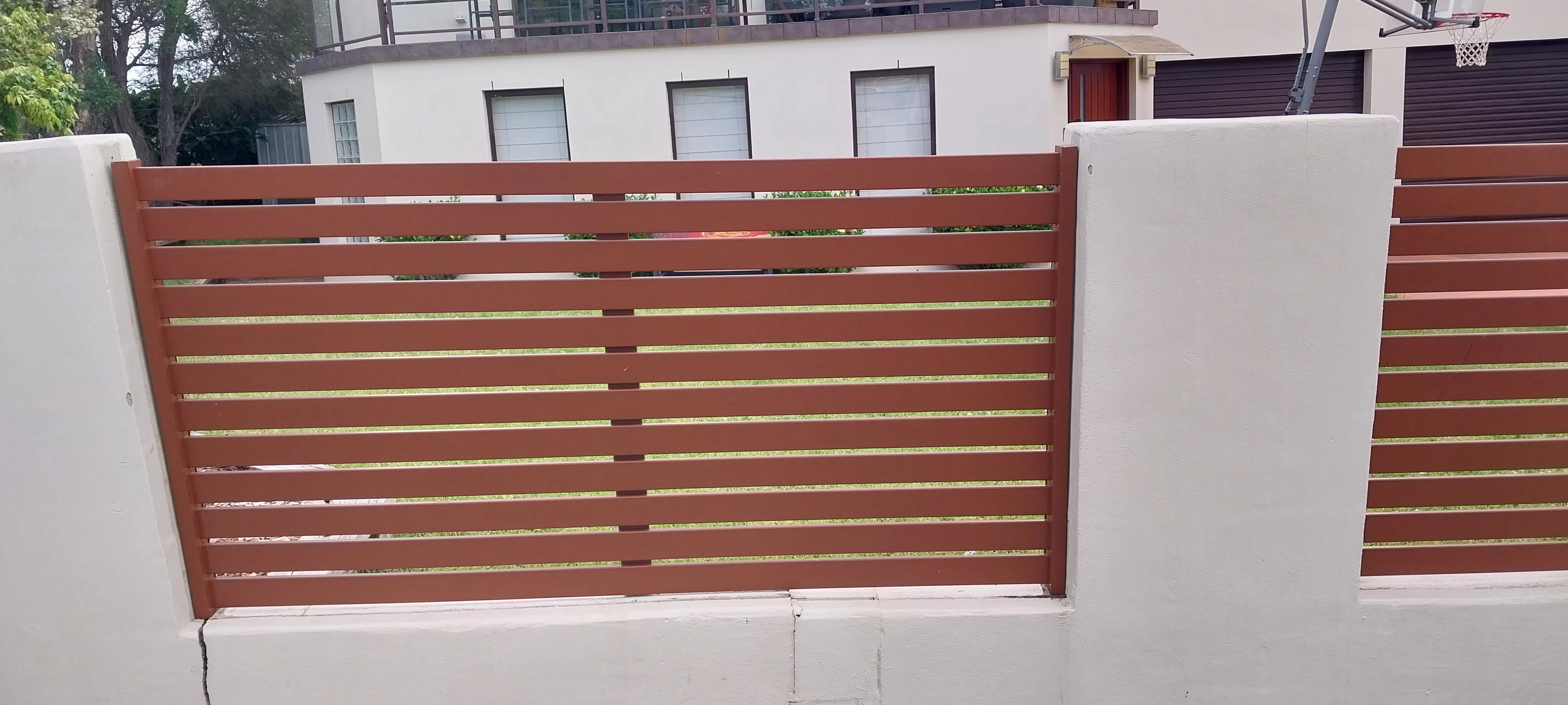

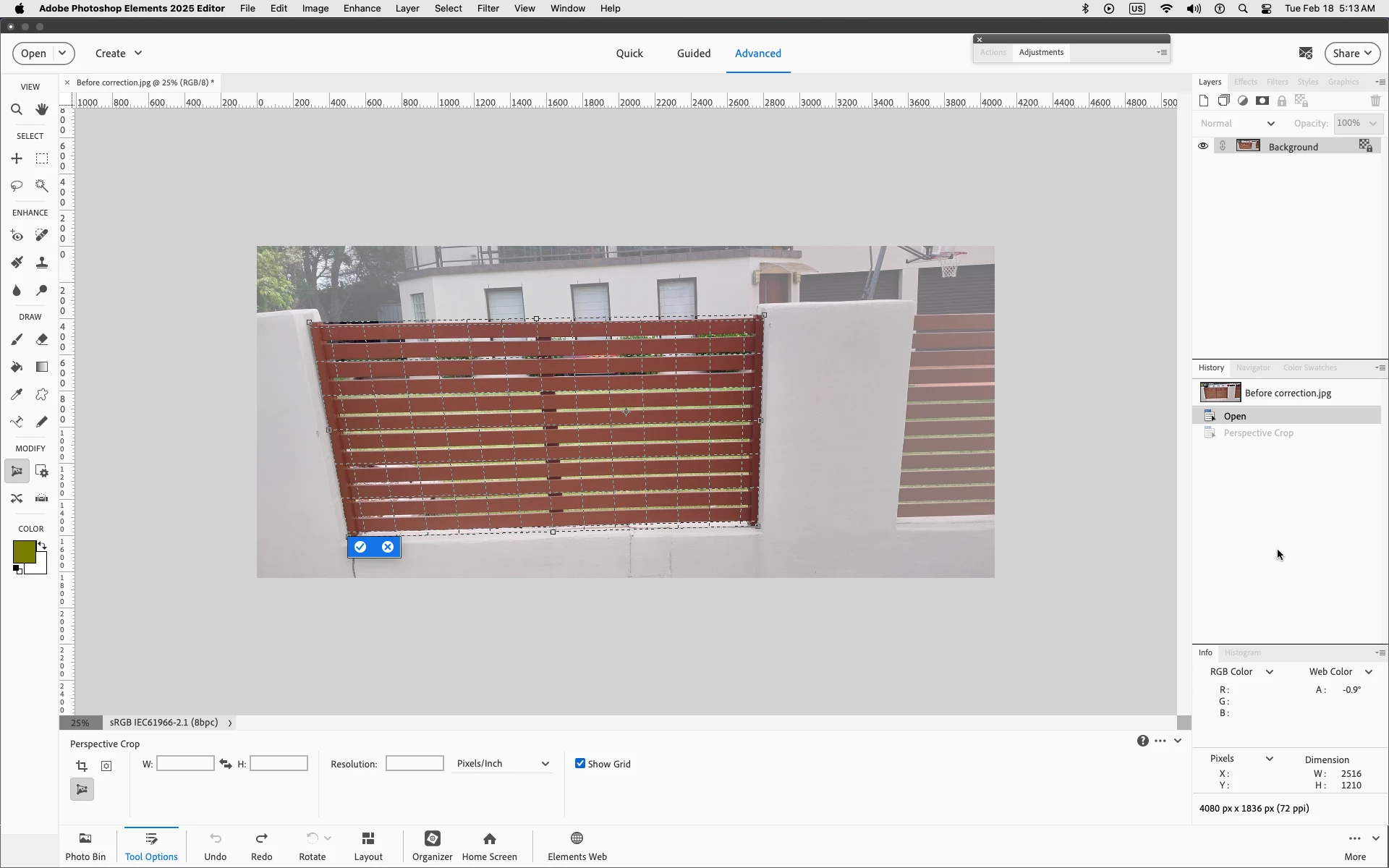

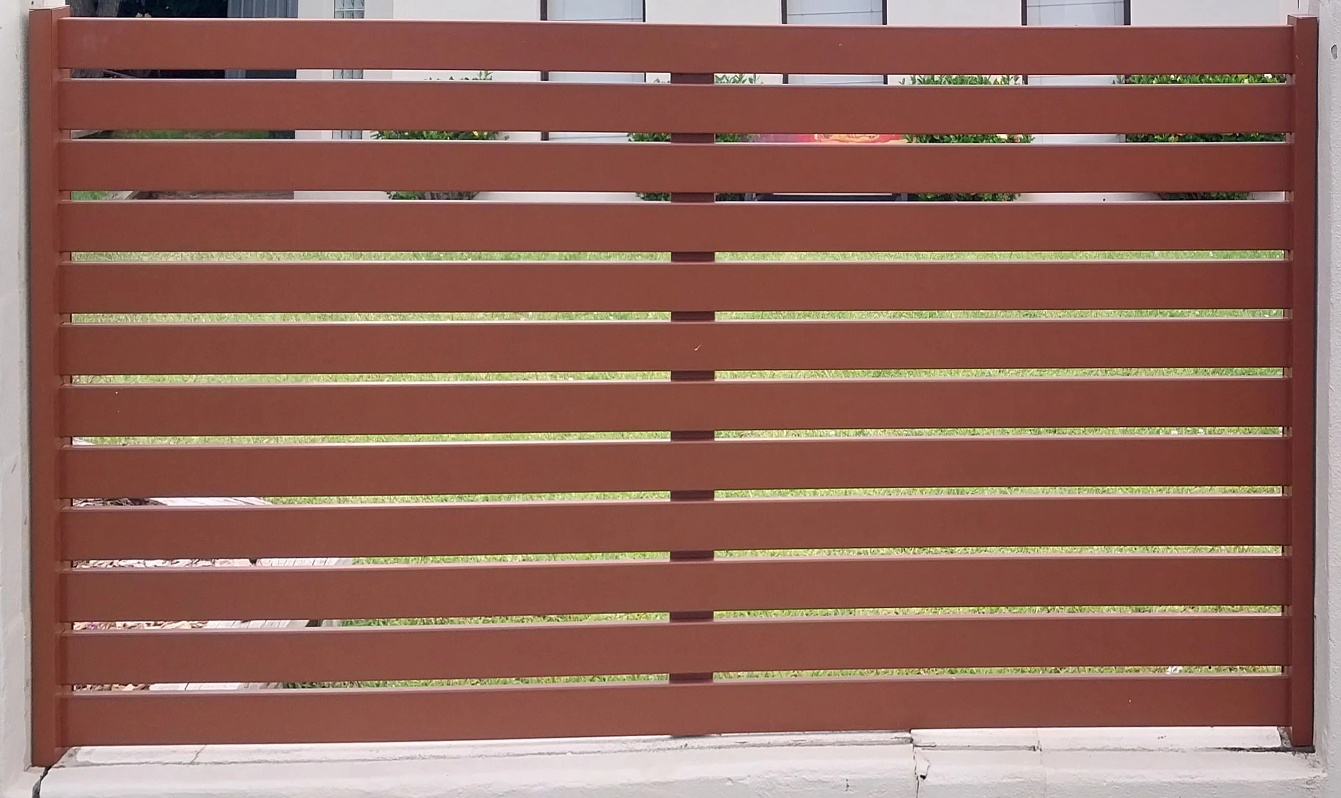

Another thing you can do with the Perspective Crop Tool in order to keep all the image is to:
1. draw out your crop around the object or fence in this case
2. extend the borders of the crop by dragging each side just outside of the image
result

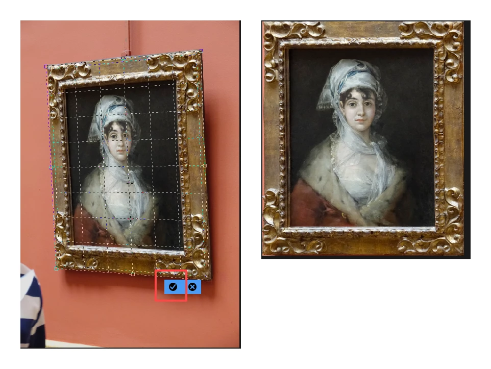

It's the same as you describe with PSP.  Click on the four corners and click the commit button (the checkmark) as shown in the following screenshot:
You can also draw a rectangle around the object and drag the corner handles to each corner.  And you can hit Return (Enter) on a Windows keyboard to complete the crop.

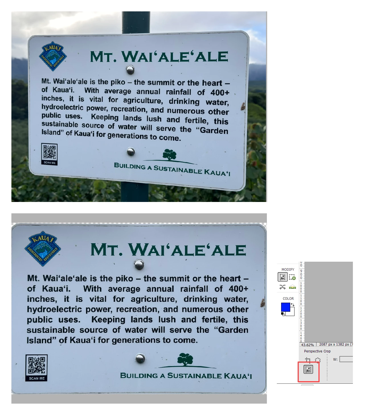

Not sure if this is exactly what you want, but the Perspective Crop tool will make that kind of correction.  It is found under the Crop Tool options.
