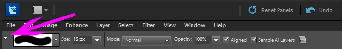

If working on layered documents make sure you have sample all layers checked on the options bar. Otherwise keep the clone tool selected and choose reset tool from the dropdown menu on the left.
