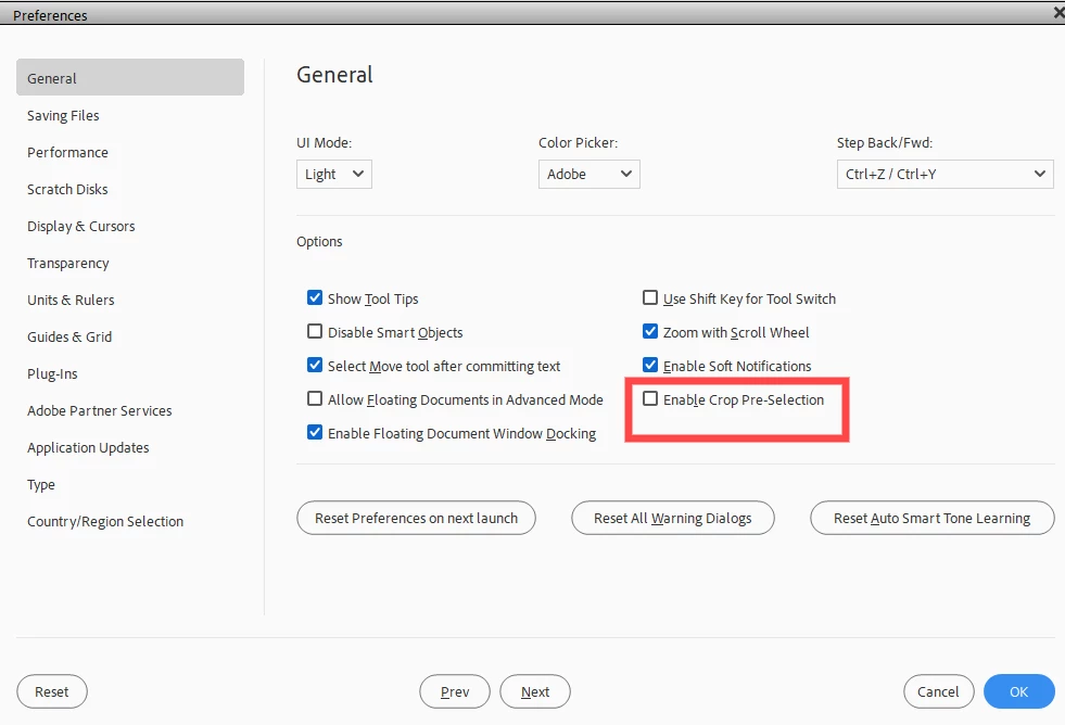

How is the tool misbehaving?
Under Edit>Preferences>General, do you have the Enable Crop Pre-Selection box checked?  If so, try unchecking it.
