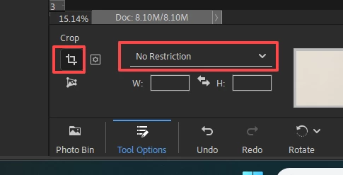

Do you have the correct Crop Tool selected and, more importantly, do you have the Tool Options set to No Restriction?
It is normal for the dashed and wiggling line (aka marching ants) to appear around the crop selection while you are holding down the mouse button.  It only changes to a solid line with handles after you release the mouse button.  You should then be able to modify the crop by clicking on a handle.  The crop is made when you click the checkmark button.

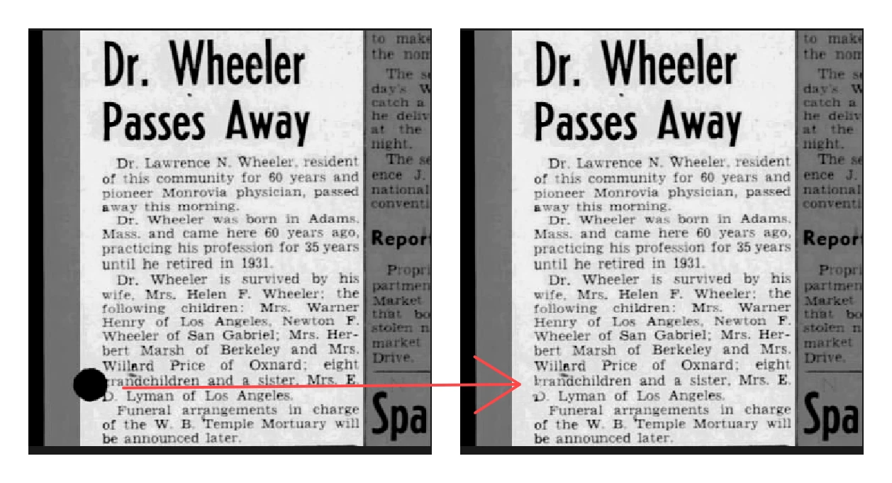

Again, it is not clear what tool you are using and what settings you have.  I am also not sure what your expectations are with these tools.  I assume you are trying to get rid of the black punch hole in the clipping.  But what are you expecting to replace it?  I'm sure we would all love for the missing letters that were punched out of the obituary to be replaced by the actual type.  But, the AI used by Elements is not going to make that happen.  Here is what I accomplished, using a round brush and resizing it to just overlap the black hole.  One click and voilà:
I suppose you could clone more complete letters from other parts of the document.  But these would only require single clicks and would not involve any smearing:

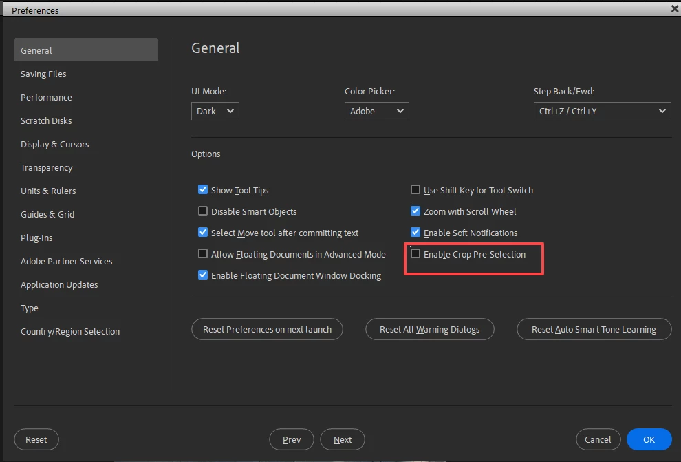

For the crop problem, try going to Edit>Preferences>General and uncheck the Enable Crop Pre-Selection box:

As per your directions, I unchecked the Enable Crop Pre-Selection box, and I changed the selection in the aligned box.  I am still having the problem.

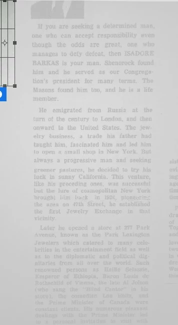

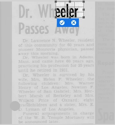

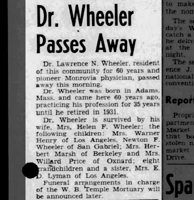

I have attached an article (Obituary) before I worked with it.  The next attachment is what happens when I tried to crop the greyed out sections of the article so that only the actual article remained. The Squirrel Mouse 2 is what happened after I tried to crop it.  The crop tool does whatever it wants.  What you can't see is what is happening while I still am holding down the mouse button on the section I have tried to crop.  My finger is still holding down the mouse, and instead of a solid line around what I marked for cropping, the line is dashed and wiggling.

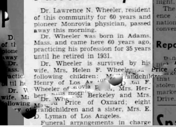

The third picture portrays the problem with the spot healing tool.  In the original photo, notice the black dot along the left margin.  As an experiment, I selected a small section of the black dot and clicked once with spot healing tool. I moved the mouse without keeping my finger down across the article to the right margin.  You can see the smear running across to the right margin.  Notice that it also placed part of the black dot in the middle of the article.
I then moved the mouse to the left margin, and you can see the tool moved part of the first and second paragraph to the far left part of the image.

I am attaching two screenshots which I hope will show you what I mean.  I can't send you one with the crop border bouncing all over the place, but I can send you one that shows the crop tool has done what it wanted rather than what I want.  Interestingly, when I made the screen shot with the rectangle tool, I had no problem cropping what I wanted to send you.  It seems the crop problem only occurs in Photoshop Elements.

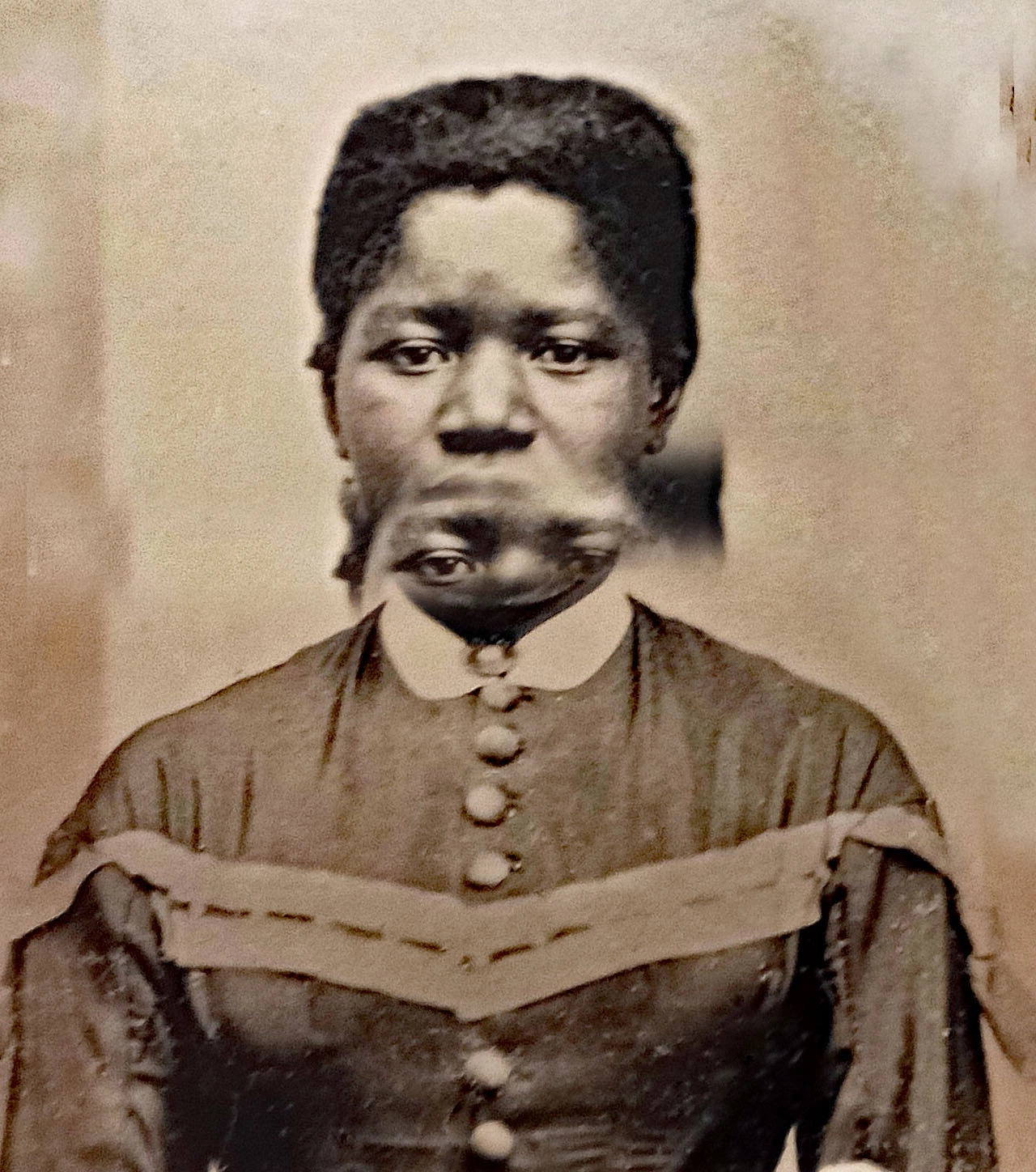

The second attachment is what I call the "smear".  It happens with either the spot healing or the clone tool.  I click on a spot to hill and then move to another spot.  Even though I am not holding keys down, the tool continues to "heal" across the photo to the next spot.  The exact same problem happens with the clone stamp.  The clone continues to the new spot I need to work on in spite of me having released the key.
