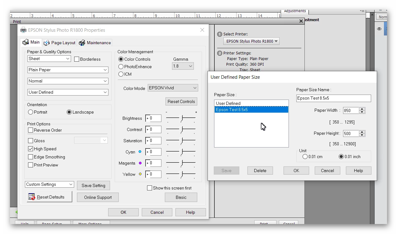

. . .  it wasn't quite so complicated with my Epson printer once I found the printer's Advanced tab.

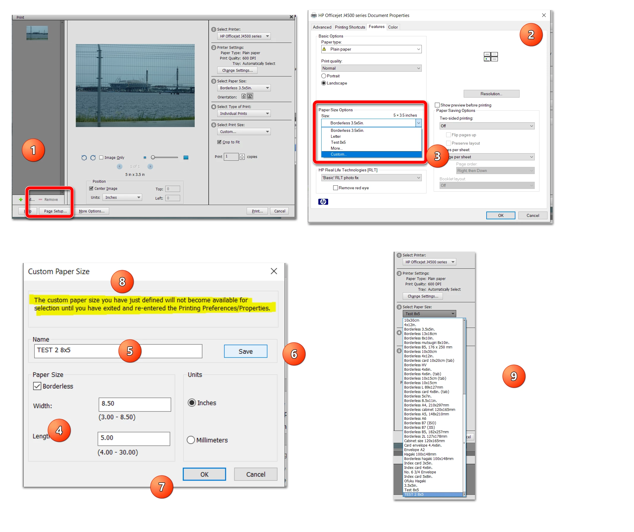

Yes, it's possible to save a custom print size, but it may depend on your printer's driver.  Here is how I was able to do it, using my HP printer:
  1. In the Print dialog, click on the Page Setup button.
  2. My HP Printer Dialog opens.  I chose the Features tab.
  3. Under Paper Size options, I chose Custom which brought up another dialog
  4. I set the custom width and height
  5. Gave the custom size a name
  6. Clicked Save
  7. Clicked OK
  8. Note the warning that you have to exit all of the dialogs and reenter the print settings window
  9. Now back in the Print dialog my custom page settings have been saved in the Select Paper Size box
Hopefully, this will give you some idea of how it is done with your printer.
