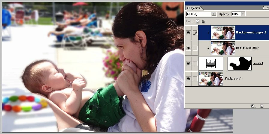

Here I used methods hatstead described.
1. Duplicate the  Background layer and apply a Gaussian blur.
2. Add a Levels adjustment layer but do not make any adjustments; just click OK. Group the duplicate layer with the Levels layer.
3. Set the Foreground/Background colors to their default black/white values.
4.  Activate the Levels layer and paint with black on mother/child to  restore the focus. If you paint too far switch to white and paint to  restore the blur. You can type "X" to toggle between black & white  while painting. You might find that a soft brush works better than hard  on the outer edges of the skin and hair; the transition between the focus and blur is not so noticeable.
5. To darken the background, I duplicated the first duplicate layer and changed the new layer's Blend Mode to Multiply. This intensifies all the colors. I thought the result was a bit too much so I lowered the Opacity to 80%.

Ok. I used the same technique described previously in detail, except that I used  Brightness/contrast adjustment layers instead of Levels.
In addition, I created a blank layer at the top, and with the brush tool painted gently over the blown out areas of the baby, and another blank layer for same for the mother.
I also sharpened and applied a stroke(rudimentary frame).
The layer structure is labeled for your reference on the print screen.
Don't hesitate to ask for help should you need it.
http://www.pixentral.com/show.php?picture=1ba9OcZL5n8rTBEnIaRfDDs04IZrhh1
provlimaAuthor
Jul 19, 2011 9:59 AM UTC
thank you very much for your help!
I will follow your steps to learn the process.  Ihave never worked with the layer feature before but look forward to learning this tool.
