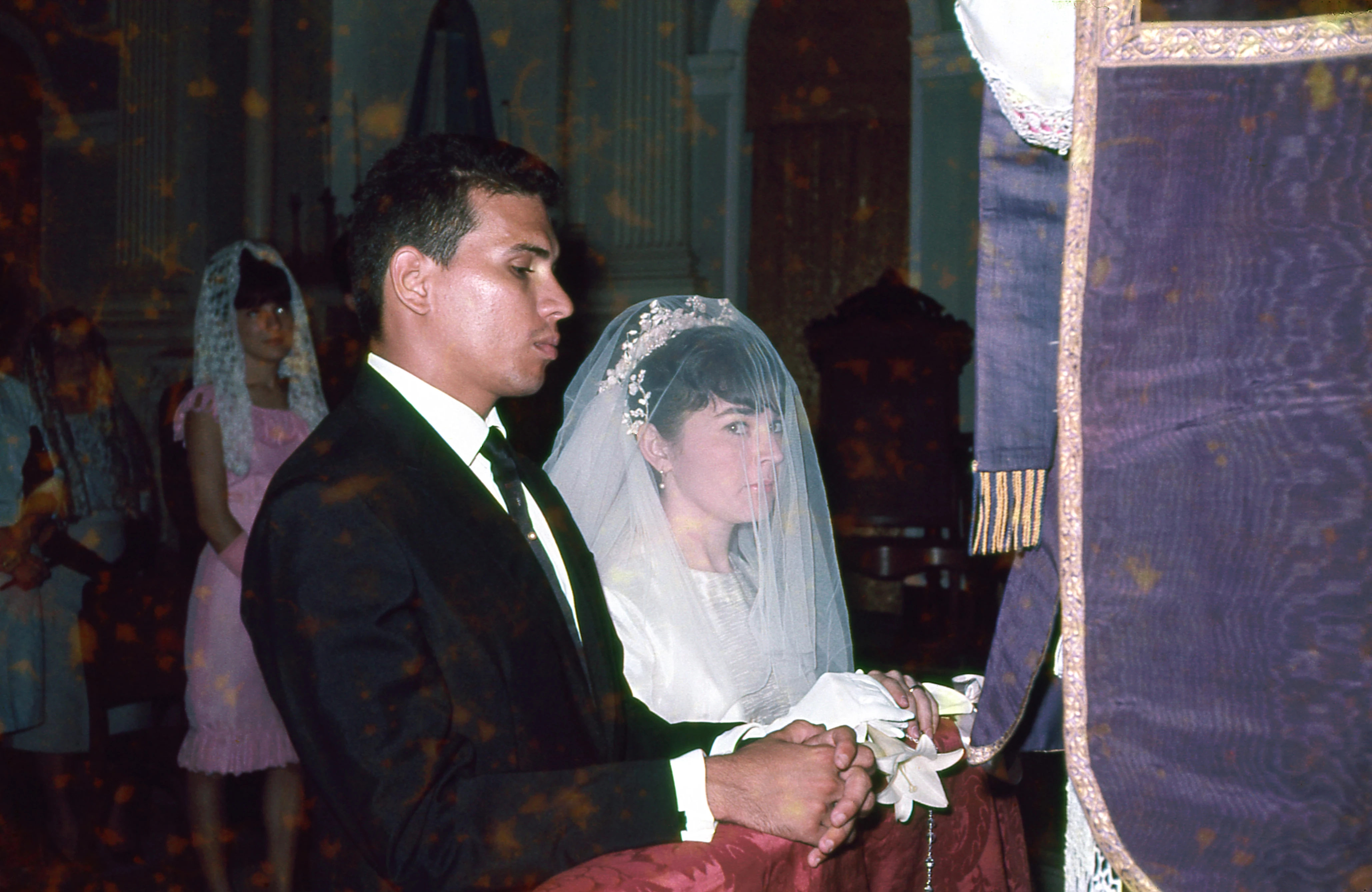

I have been trying to restore my parents old slides and they all have discoloration due to mildew and mold. How can I fix the discoloration with elements? I was able to find one video on youtube with a similar problem but couldn't really undertsnd the steps. https://youtu.be/LKyVYyMc8pM
I'm attaching one of the pictures I'm trying to fix as an example.
Would greatly appreciate the help!!

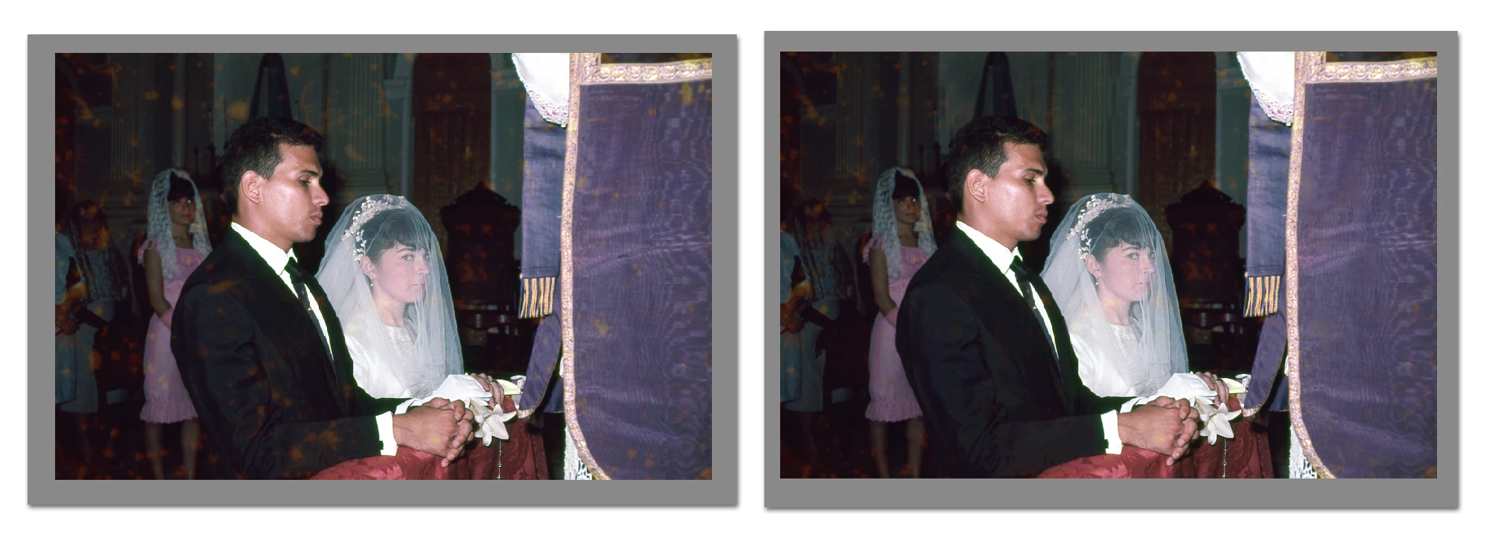

Here is a before and after of some of the changes I was able to achieve using these techniques.  Since I am not sure of your experience level, I have probably left out a lot of details.  If you need more assistance, let us know.

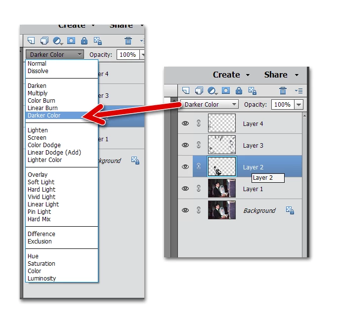

In case you don't know what I'm talking about with layer Blend Modes, here is where to look:
