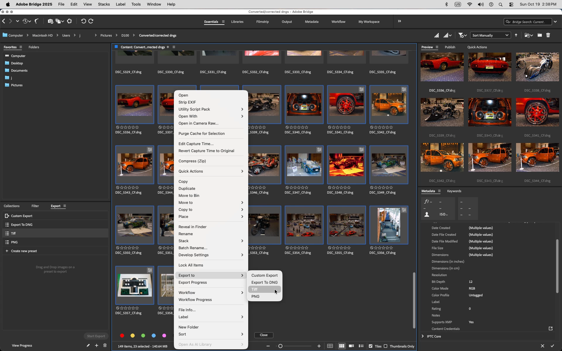

You could also use the Export panel in Bridge to convert the DNG files to Tiff files, which should then open in Photoshop Elements via File>Open in Camera Raw.
Oct 20, 2025 2:24 AM UTC
Thanks so much for this tip. I have the free version of Bridge so my only options for Export are Custom and DNG. But from your suggestion, I played around with the custom option and buried 2 screens deep was the option to save as .tif!!!  This will make my workflow easier bc I can batch process the .dng files rather than doing them one at a time!  Thanks for pointing me in the right direction!!!
