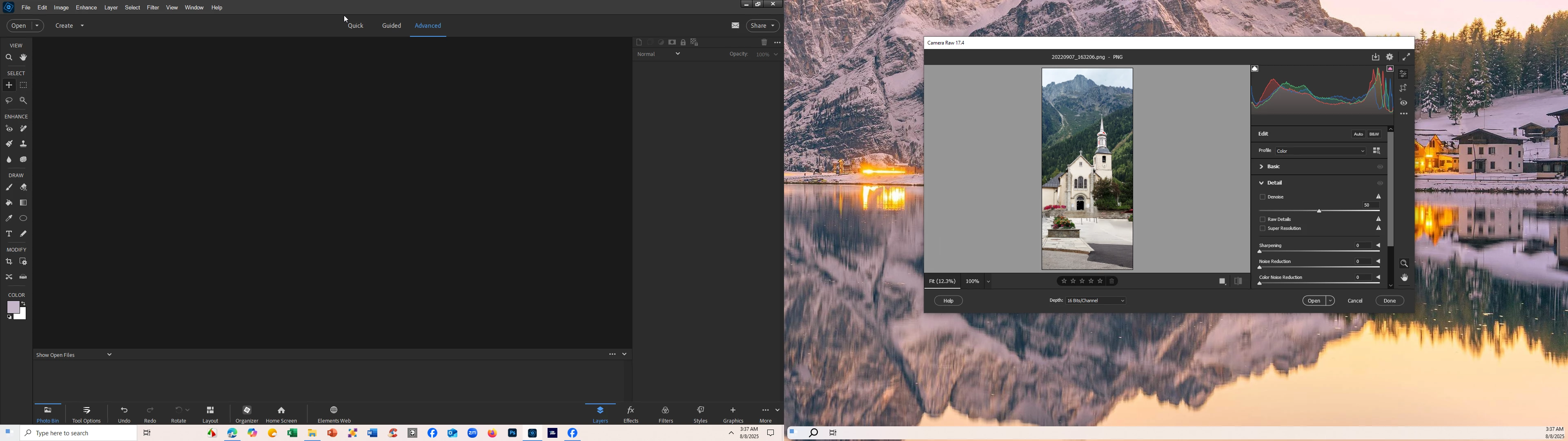

I do believe I've found a solution:
Below:  A screenshot of my two monitors- the right side with the winter scene in the second monitor.
The  solution:
By default the ACR window has been opening up with the very top, usually white part of the window hidden.  Once I made the ACR widow a bit wider, I could grab the whit part and drag ACR over to the second window.
Once doing that it's now easy peasy for me to put ACR  on the seocnd monitor.
If you haven't done so allready you would need to change what happens when you close your laptop screen when you close the lid.
