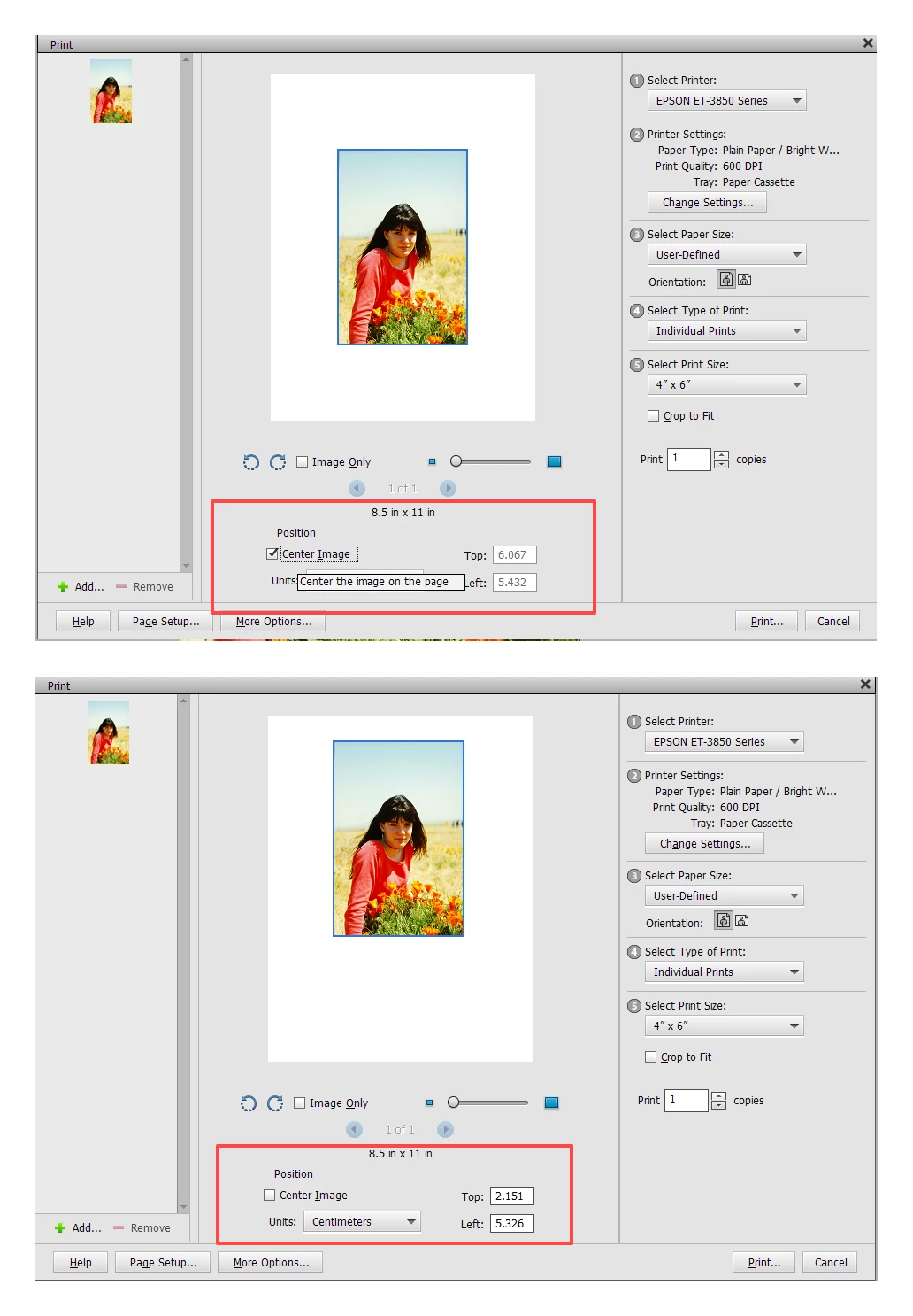

I've just taken a look at the printer in Elements 10, and I can see the difference in behavior.  It looks like this is a bug to me.  I don't know whether this is just related to Windows 11.  @hatstead can you check on Windows 10 to see whether you can move the blue frame box on the page by entering different numbers in the boxes displayed in my screenshot below?  For me, the numbers do change when I move the blue frame manually.
But if I enter the numbers in the position boxes manually, it is the image that moves, not the blue frame around it:

Jun 27, 2023 7:27 PM UTC
If you hover over the blue frame, the cursor should change to a four-headed arrow.  If you then click on the frame, you should be able to move the blue frame wherever you wish.
As an alternative, you could create a new A4 size document in the Editor and copy and position the image into that document.
Jun 28, 2023 9:41 AM UTC
Shortly after entering my question, I found out that I don't have to touch the picture, but the blue frame. This practically solves my problem. Many thanks for the answer
