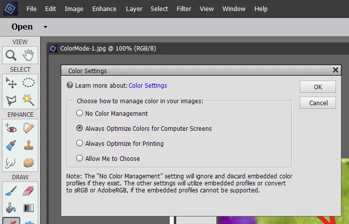

jdaadeb wrote I just bought Elements 15. Before editing any photos I went under Color Settings and clicked "Always Optimize for Printing" as I planned on printing them on my printer at home. I'm not getting prints that I like (not really bad but just enough difference that I don't like them). I've worked two days, and used lots of ink, on trying to get the prints to match my laptop screen. Since I'm not willing to spend money on a calibration system I've decided to just use an online lab. |

- The option 'for print' is for aRGB, for 'computer screen for sRGB.

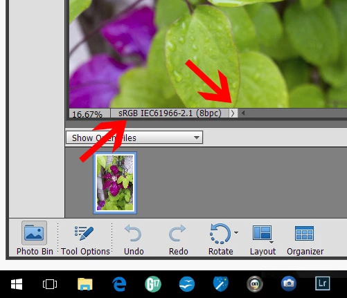

Your jpegs are in the mode selected on your camera, generally sRGB. Your setting on Elements will be used even if you select the other one, because Elements will use the mode tagged with your jpeg. It will only select the other if the tag is missing.
Your raw files have no color mode: in Elements the conversion process in ACR looks at your setting (print or screen) and convert accordingly. As a result, all your edited raws are aRGB while your jpegs are as set by your camera, probably sRGB.
