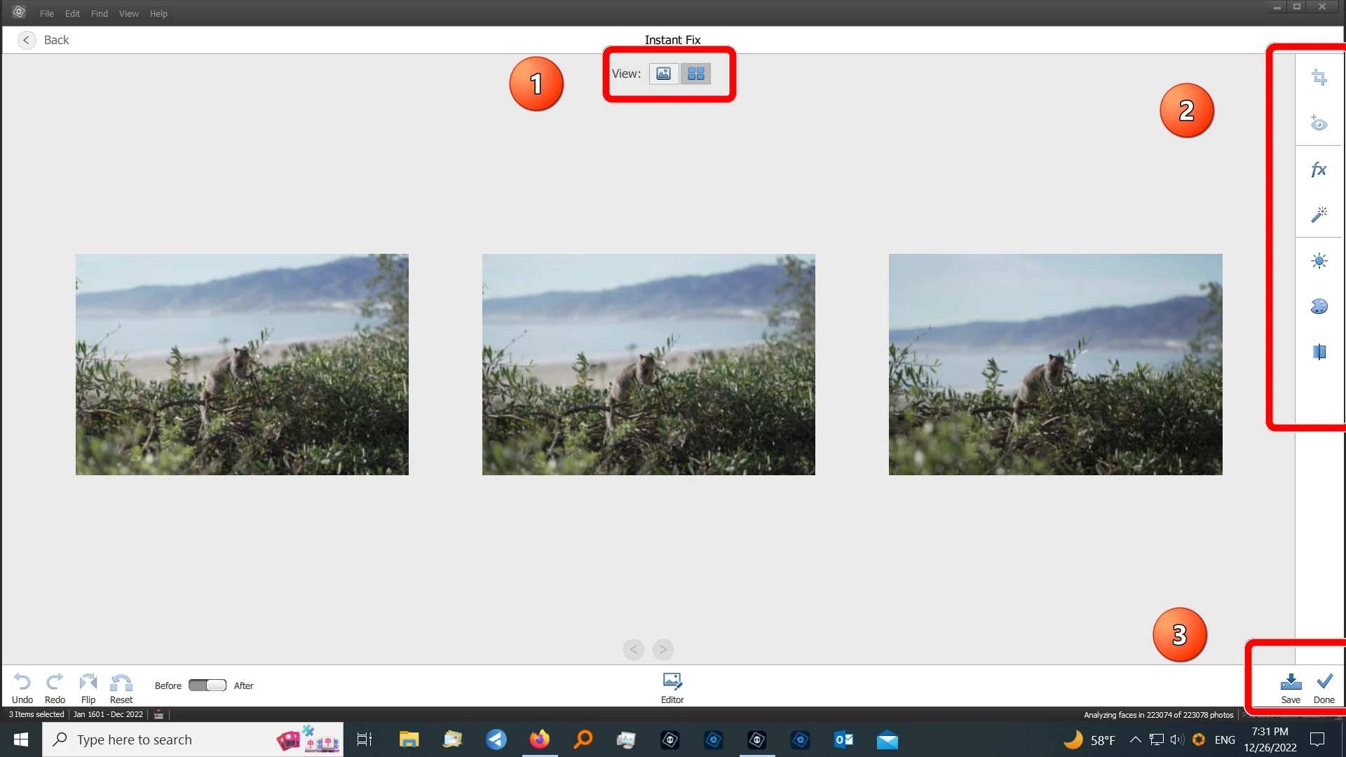

There is something you can do that makes saving files a little easier in the Organizer.   This will work for editing single files or even multiple files for which you want to make the same edit e.g. improve the exposure or color or clarity.
  • Select one or more files for editing in the Organizer
  • Click on the Instant Fix button.
This will bring up the Instant Fix editor:
  1.  Using the view button, you can work on a single photo or multiple photos.
  2. There are several editing tools.  But you can only use the crop tool for one photo at a time.
  3. When you are done, click the Save/Done button.  The Save button will save the edited file as an automatically renamed jpeg in a Version Set with the Original photo.  With or without clicking the Save button, you have to click the Done button.  You will be prompted to save your edits (if they have not been previously saved).  Click Yes and the file is saved in a Version Set - with the edited file appearing on top of the stack.
No fuss, no muss!
The Instant Fix is a great tool and I use it frequently for quick edits.
Now as for HEIC files, Elements can handle them (if you install a free Microsoft Extension).  But IMO if you have found a solution to transfer them to your computer as jpegs, there is no reason to change your workflow.  The Instant Fix tool can handle HEIC files and also raw files.  It will save edits to both as jpegs.
One final note, in order to unstack the version set so that you can see both the original image and the edited one, you need to be in the Organizer's Details view.  Press Ctrl+D to toggle between the default view and the Details view.  With that, I will try not to overwhelm you further with new information.

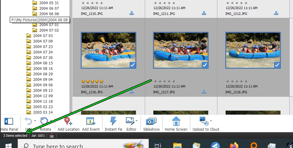

@seniornewbie said: I did have one minor question. If I have a bunch of pictures on the screen in Organizer how come I cant see a number telling me how many pictures are present.
I'm not exactly sure what your question is.  The number of (viewable) files in your catalog is displayed in the lower left of the Media grid.  If you select some files, the selected number will replace the total number.  If you use the Instant Fix editor to edit several files, the number selected will be shown too.  However, I have just noticed that if you toggle between Show All Photos and Show Single Photo view in the Instant Fix editor, the number displayed will be the total number that are viewable in the catalog.
And by "viewable" photos, I mean the number of files that have not been hidden from view in the catalog using the Edit>Visibility>Mark as Hidden command or files that are in Stacks or Version Sets that have not been expanded to view all of the photos in the Stack or Version Set.
Jan 12, 2023 2:57 AM UTC
Thanks again, I guess I was so fixated on absorbing the entire catalog screen I didnt gaze any lower than the bottom tools where the instant fix icon is. I then lowered my eyes to the black section that you pointd out with your green arrow (love that) and DUH, there it was --the NUMBER of items. This learning curve is so tedious and reading the guides sometimes is worse as it brings me down rabbit holes. if it wasnt for the fact that you told me to go into details view to see the both original and edited photos it would have taken me an hour to figure it out. I think I'm correct when saying the photos in the catalog are just links to the real ones on my hard drive--correct? I did a smart fix on a 130 phtos. Is there a quick way to delete the original ones. So I can figure out what to do with the edited ones?  I cant wait until I know how to use the tools (and where they are) so I can start having some fun. Im not in this for any kind of business-just to have fun in my senior years. Thanks for you kind help.

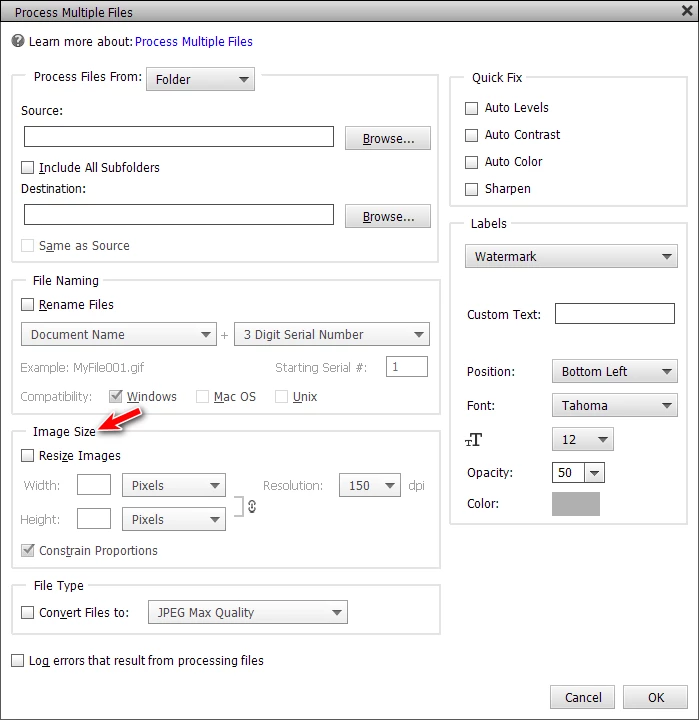

WHAT!! is this what has to be done?? Yes
That sounds crazy. Am I being ignorant about this??  Pretty much you're spot on.  You gotta do that 4 step thing you listed for each image.
Batch processing involving cropping / triming is not an option.  You can bulk resize a bunch of images (changing 1200 x 1200 down to 400 x 400 for example).
