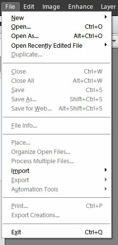

    Similar to the above - a JPEG I've opened in ACR and changed, and saved, then opened from Organizer doesn't go back into ACR, it goes straight into the editor.  The Organizer doesn't appear to know anything was ever done in ACR.  As for opening a batch of jpegs - I don't have anything that looks like "Open in ACR" from the editor...  When I pull down the File menu it looks like this:
    Am I missing preference?  Or do I need to tell the Organizer to re-import or something equally bizarre?  Some switch SOMEWHERE?

    I should have mentioned that I no longer keeps PSE11 on my computer (I still have versions 10,12,13,14 and 15.
    I thought that the ability to open several jpegs at the same time was introduced with the major changes disclosed in version 11, but from your post I do see that PSE11 is identical to PSE10 in that respect.
    Since PSE12, in the file menu, the option to open as "raw...." is replaced with an option to 'Open in ACR' (in Windows, it's probably a little different in Macs). In the 'Open in ACR' you can select several files by Ctrl or Shift click (raw or jpeg) and open them at the same time.
