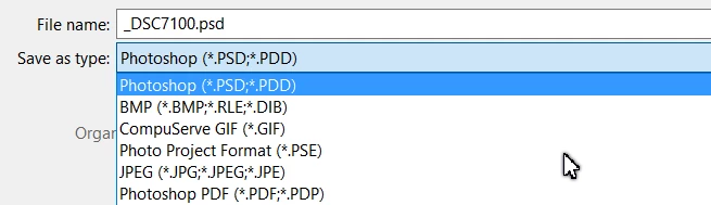

    What OS are you using?
    Are doing a Save or a Save As?
    If you are using the Save button, the message is normal.
    If you are doing a Save As, are you sure that the Save as type dropdown menu is not set to psd?

    Save as is used all the time not save so I knew this wasn't the culprit
    However,  tried selecting the PSD previously saved so I ensured I had the name absolutely right but changed the file extension once the file name populated the name box.   No an industry standard convention admittedly but due to the file naming protocol it was the safest as some files (pictures)  change slightly for different use i.e. EU_roof_sector_BRN-1 then a slight shade change would require EU_roof_sector_BRN-2
    It this that causes the issue. It appears that even when selecting the name to save and changing the file extension the system seems to be remembering the original file selected to save and warns about an overwrite.  If I key the name in full or save to another folder no issue.
    Strange to see it suddenly do this but - its something to be aware of. my side.
