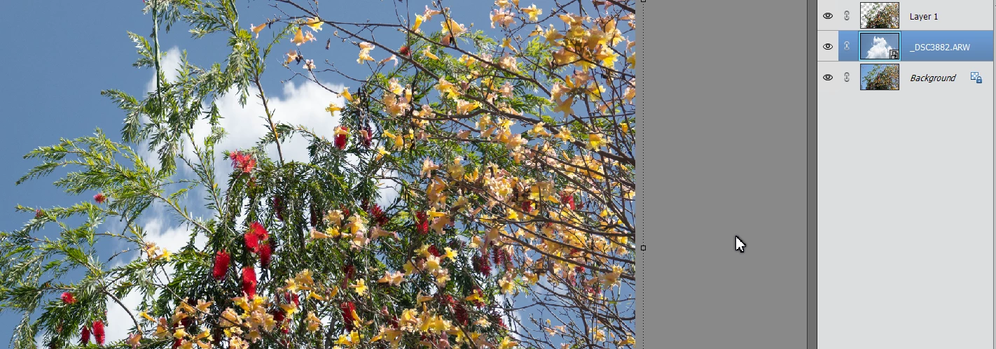

    Jul 11, 2019 9:21 PM UTC
    Thanks for yur help but I still have a problem. First i did go to the
    fuull discussion. Everything was as you said until the last step.
    I selected the cloud image. But ONLY the Cloud Image appeared. In your
    video the following appears: Layer 1, the Sky Replacement, The
    Background. While only the Sky Replacement appears in the layers area
    on my computer.
    At this point I was stymied.
    Any help would be appreciated.
    Frank

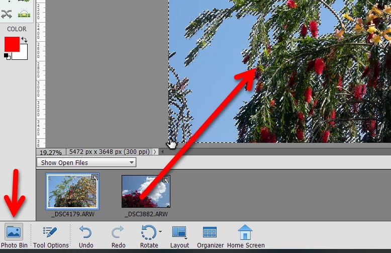

    Greg_S.
    Jul 11, 2019 10:47 PM UTC
    If you click on the Photo Bin toggle in the lower left corner of the Editor, you should see your two photos (the tree and the replacement cloud).
    Select the tree image and it will appear in the editing window.
    Now, click and drag the cloud image from the photo bin to the tree image in the editing window.  This will create a new layer at the top of the layers panel and the cloud will appear in the edited image.  (It sounds like you had the cloud replacement image selected in the Photo Bin.)
    Select the Move tool (Press V) and drag Layer 1 to the top of the Layers panel.
    You may need to resize or move the cloud layer around to suit your composition.
    Hope this clears the skies for you.
