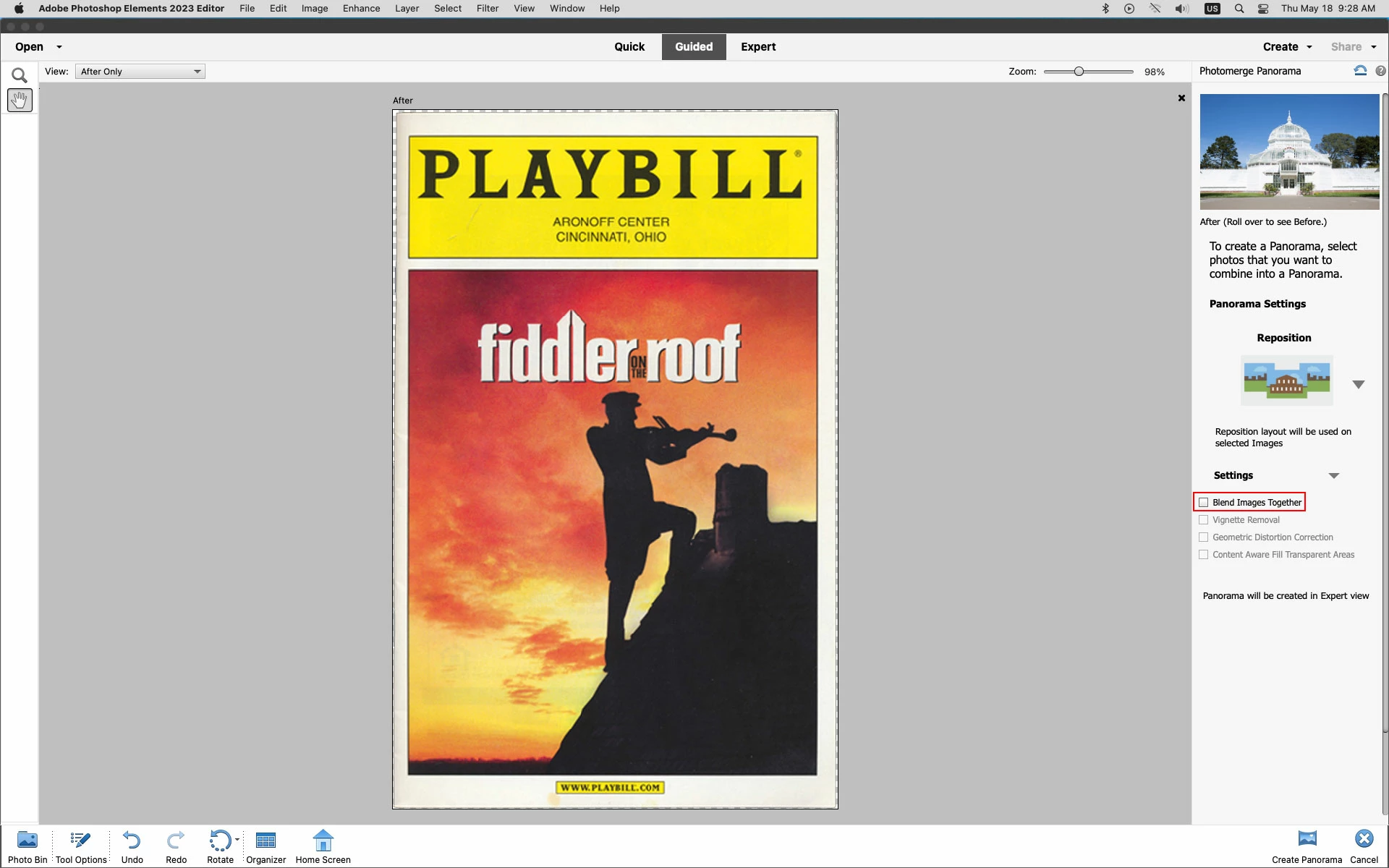

In Guided Edit>Photomerge>Panorama when selecting Reposition uncheck Blend Images Together under Settings.
Then you'll get separate layers.

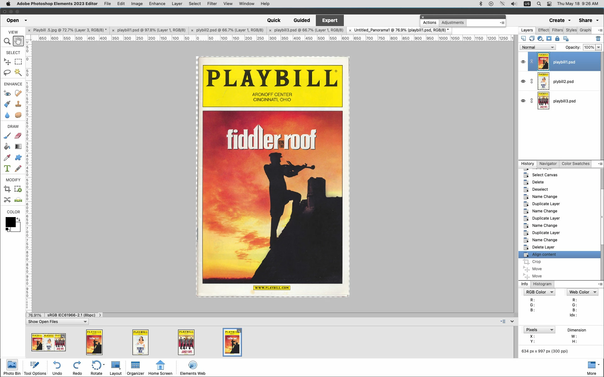

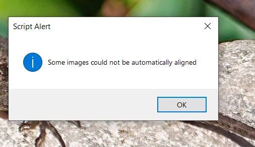

I had tried with Blended unticked, but I have just tried again.  I still get the message  "Some images could not be automatically aligned", but the in the next screen I can slightly see the underlying image (The underlying one is a little wider and I can see a a tiny bit of it).  But I am still lost with the next step.  I put the cursor into "move" context (it changes to a hand).  unfortunately when I then try to dragthe top image nothing happens.  I've tried with the left click down, and also the right click down as I drag.  I found instructions for a very old version it said to hold the space bar down as I drag, but all to no avail.  I'm doing this in the "Expert" tab.  Can you tell me how to drag?  Try saying that to a teenager!

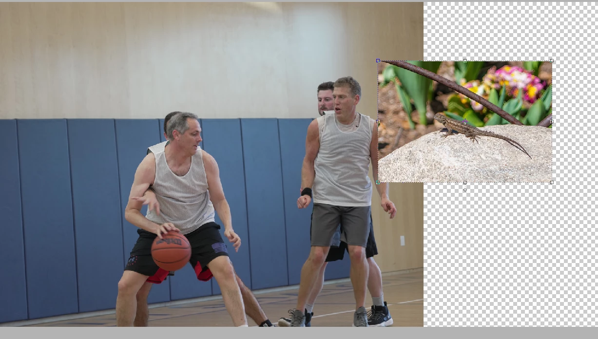

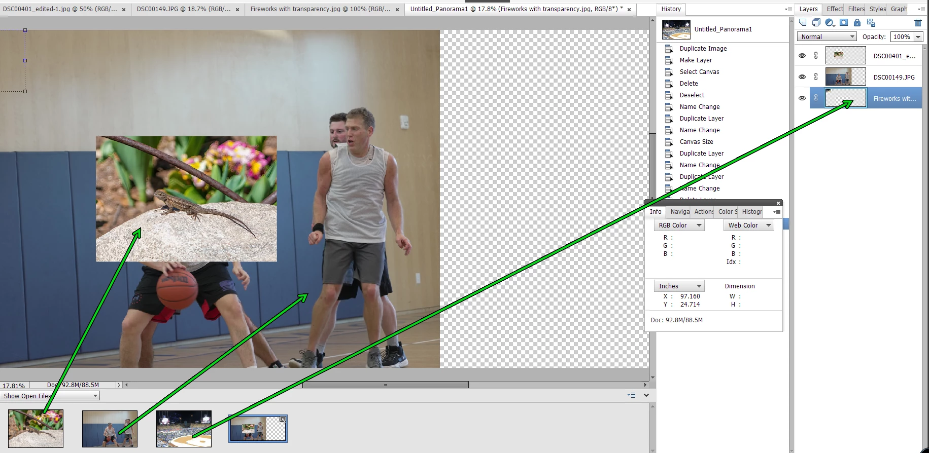

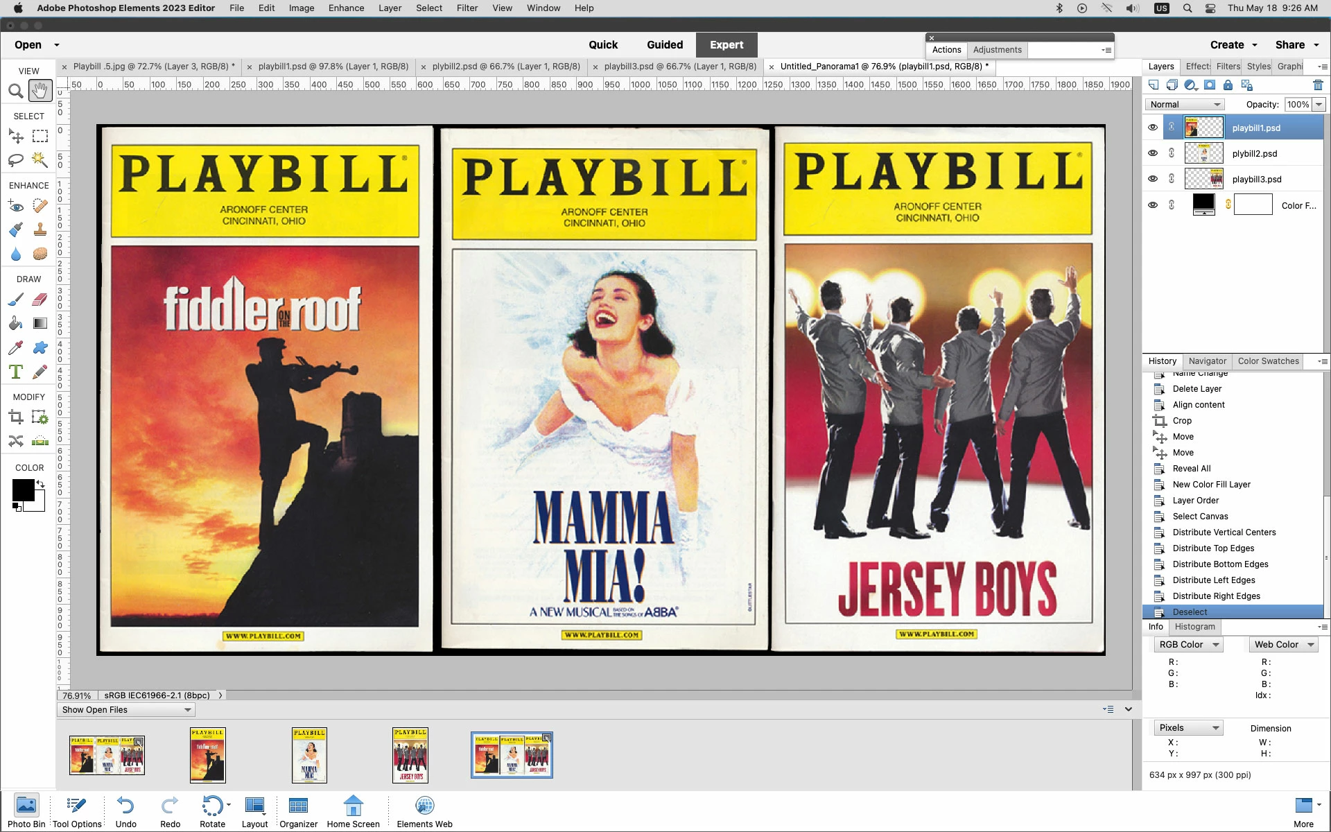

@99jon, in my quick experiments with the GE, it seemed to me that the GE was trying to line up the images as if they were a true panorama and not a collage.  I used the Playbill images from the OPs screenshot and the program seemed to recognize that they had similar borders and tried to line up one of the single images with borders from the other 2 images. It (mistakenly?) cut out the centers of the Playbills perhaps because it was only trying to line up the edges.  Hence, what remained was the transparent pixels from those other images that I think you are describing.  I didn't try every configuration of the GE so I may be entirely wrong about that.
So, in the following screenshots, you will see that I have attempted a Panorama GE collage of 3 very different images.  The GE threw up a message that some images could not be automatically alligned.  The net result was that the basketball image became the base with the lizard placed in the middle, and the third baseball stadium image was almost entirely cropped out and hidden as the background layer.  It was possible to resposition each of the layers in Expert Mode.
I think the bottom line is that the panorama GE is not intended for true collages, but allows for panoramic collages of the same scene with different images lined up to form contiguous pixels where possible, but not necessarily in a rectangular result.

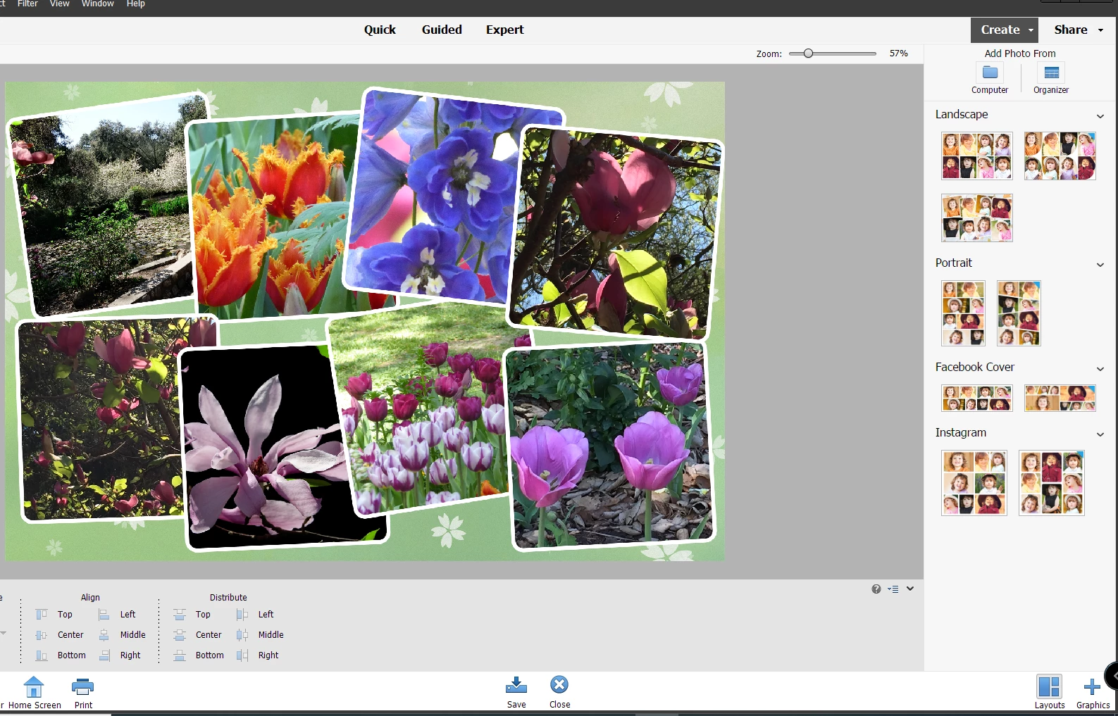

You may want to look at the Collage Creator in Elements 2022.  It can create a collage with various templates and with a maximum of 8 images.  You can select your desired photos in the Organizer and then go to Create>Photo Collage.  The program will automatically create something like the following.  Once the collage has been created, you can edit it further in the Collage Creator (by moving around and resizing the photos or changing the background), or in the Expert mode of the Editor where you can change everything.

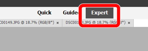

I think you must be in the Quick Mode which is the default upon installation.  Change to Expert Mode and you will be able to move each image around since they will each be a layer in the new file.
Mar 21, 2022 4:09 PM UTC
Thank you for your time and consideration. I have done this with some success. I just need to work on it. I am actually trying to make a composite of 11 disparate images. This was a snap in Elements 9, but I'm sure I'll get the hang of it with 2022.

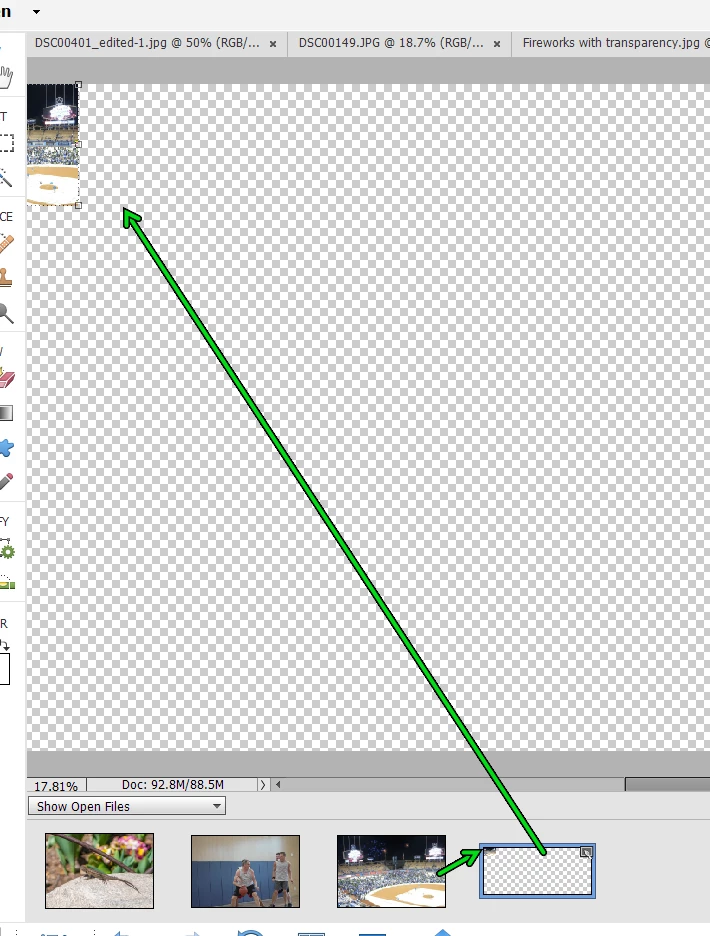

Elements 2022 can create a side-by-side collage of two images just as you have described.  If you want to create a collage of two 6x4 images, you could create a new file measuring 12x4 and drag, drop and position the two photos from the photo bin to the new file.  If you really want to create a true Panorama, you will find tools in the Guided Edit>Photomerge panel:
As with most things Photoshop, there are multiple other ways to accomplish what you want.
Mar 19, 2022 9:00 PM UTC
Thank you for your comments.
I recently upgraded frtom Mac Sierra to Big Sur. With Sierra, I was using Adobe Photoshop Elements 9.
I have created a new blank file and dragged 2 images from the Photo Bin into the window. The two images become superimposed one on top of the other. I am unable to separate them into a new side-by-side image.
