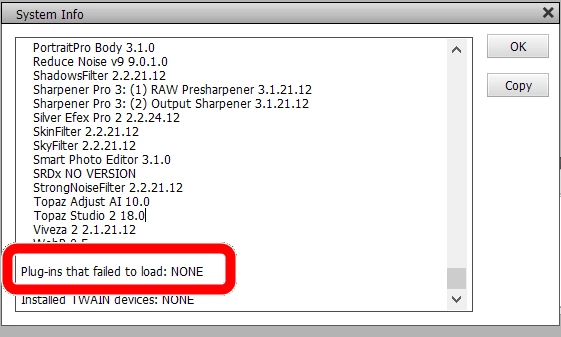

For future trouble-shooting, if you use the Shift key while launching the Editor, you can prevent all third-party plug-ins from loading.
Also, if you go to Help>System Info . . ., at the end of the list, you will find any problem plug-ins that failed to load.
In my experience, there are almost no Photoshop plug-ins that fail to work with Elements.  The only ones I can think of use Actions for commands that are not available in Elements.
