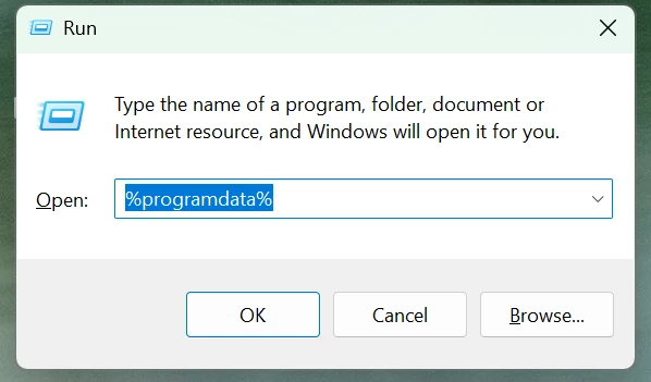

    Launch the Windows Run dialog (Windows key+R) and type %programdata% and hit return

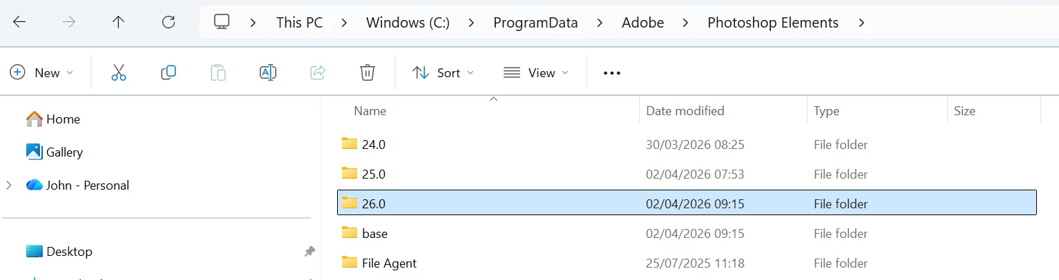

    Navigate to: C:\ProgramData\Adobe\Photoshop Elements - see images below
    Delete the folder 26.0
