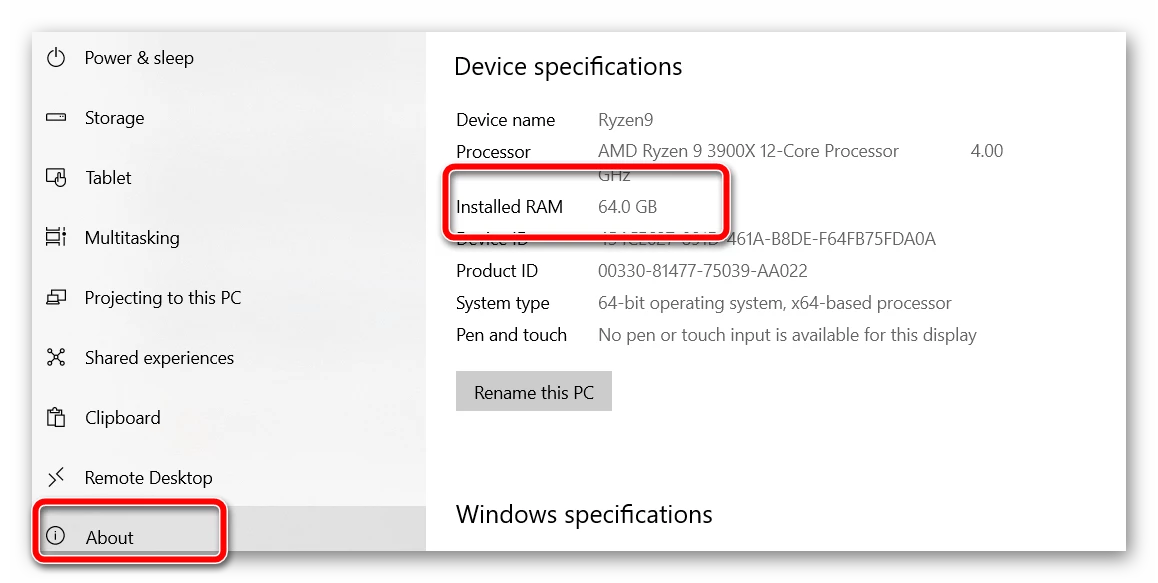

To find out how much RAM you have, go to Windows Settings>System>About.

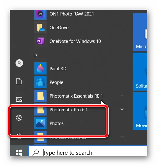

@Darlene Fr said: I don't understand where to find the photos app. The print is so small in your screenshot that I can't see it. Could you please tell me how to access it?
If you click on the Windows Program Menu, you should have Photos listed as a program.

Some final questions:  How much RAM do you have on your computer?  Since Elements 15 is able to handle the import, this really shouldn't be important, but I am a little curious.  And what camera are you importing from?

I'm pretty sure I have a lot of RAM-that was important to me when I ordered this lousy computer 2 years ago. If you could tell me how I can find that out I will let you know how much I have.
