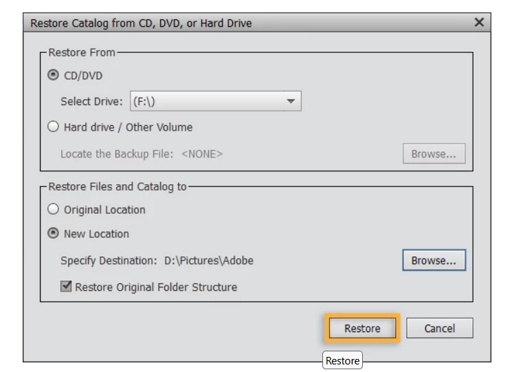

Wow, I may be having a similar problem.  But before I jump to that conclusion, I need a little more information from you.
I assume you transferred your catalog from the old machine to the new one.  How did you do that?  Backup and Restore using the Organizer's tools, or some other method?
If you restored the catalog using the Organizer, did you use the option to Restore Files to the Original Location or a new one?  And did you choose to Restore the Orginal Folder Structure?
Any other details you can provide about your file management and getting the files onto your new computer will be helpful.
My personal situation is a little different.  I have been trying to move my catalog onto a new larger hard drive.  I managed to Backup the full catalog, but when I restored it, to a new location (the new drive), the catalog still points to the old drive.    Now, when I reconnect the files to the new drive, the old entry in the catalog remains, so I have a properly connected thumbnail and also a missing file generic thumbnail.  But if I delete the missing file, the correct one remains.  I haven't noticed any changes in the extension case.
I know nothing about Macs and you situation may be entirely different from mine, but misery does love company.  (I have to reconnect over 250k files!)
