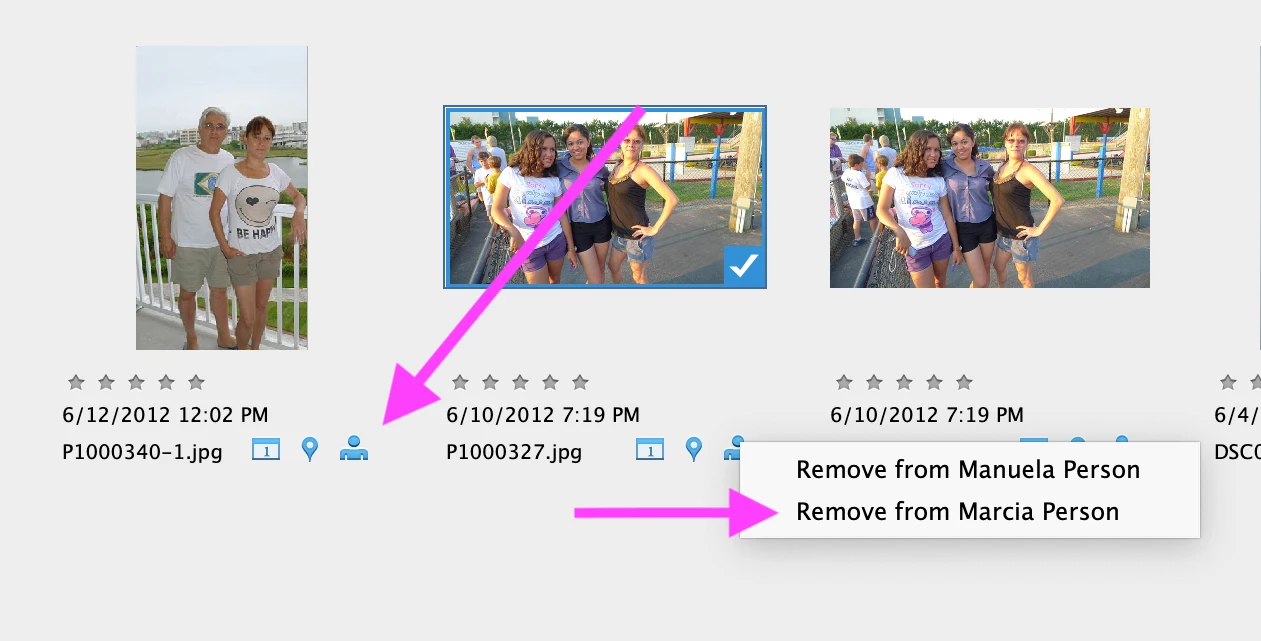

Monte307
Jul 31, 2023 9:19 PM UTC
Select the images with the incorrectly tagged person, then right-click the little man icon in the lower right.  Then select the incorrectly tagged person to remove (see attached).
