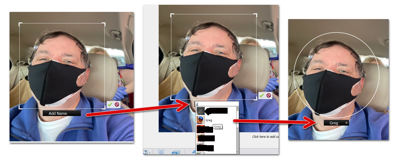

I just tested this out with a photo of me wearing a mask.  Not surprisingly, face recognition did not recognize me.  In fact, I had just imported this photo a day or two ago and because I had all media analysis turned off, face recognition had not yet been started.  I used the Mark Face tool and gave permission for analysis of the photo to proceed.  This took maybe 20 seconds.  After the analysis was completed, I was able to mark the face.  I moved the rectangular marquee over my face and clicked in the Add Name text box.  After typing the letter G in the box, several names beginning with G popped up in a list. I clicked on Greg, my full name was entered in the box and after clicking the green checkmark, the name was added to the photo.  This feature only works in full screen (single image) view of the grid.

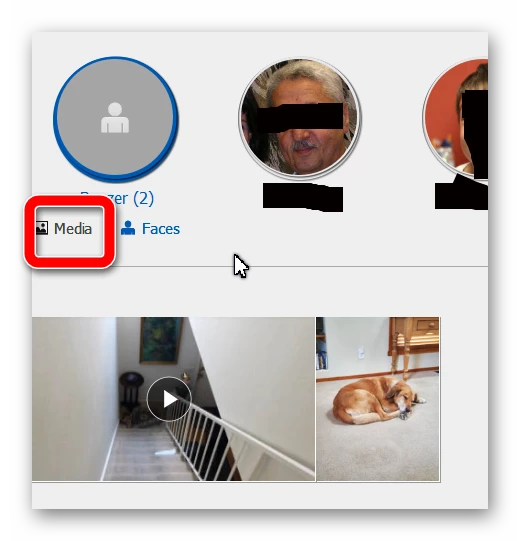

  • If the information is readily available, and you only have less than a dozen photos to add at a time, do you really need to have the face recognized?  For your purposes, wouldn't it be sufficient to simply drag a People name tag (new or existing) from the tag panel to the photo(s) of that person that you have just scanned?  You can always find photos of that person by clicking on the name tag.  A stack of photos with that person in it will also be available in the Named People room.  Although the thumbnails of the faces will only be generic, the photo thumbnails will all be available by clicking on the Media option.
