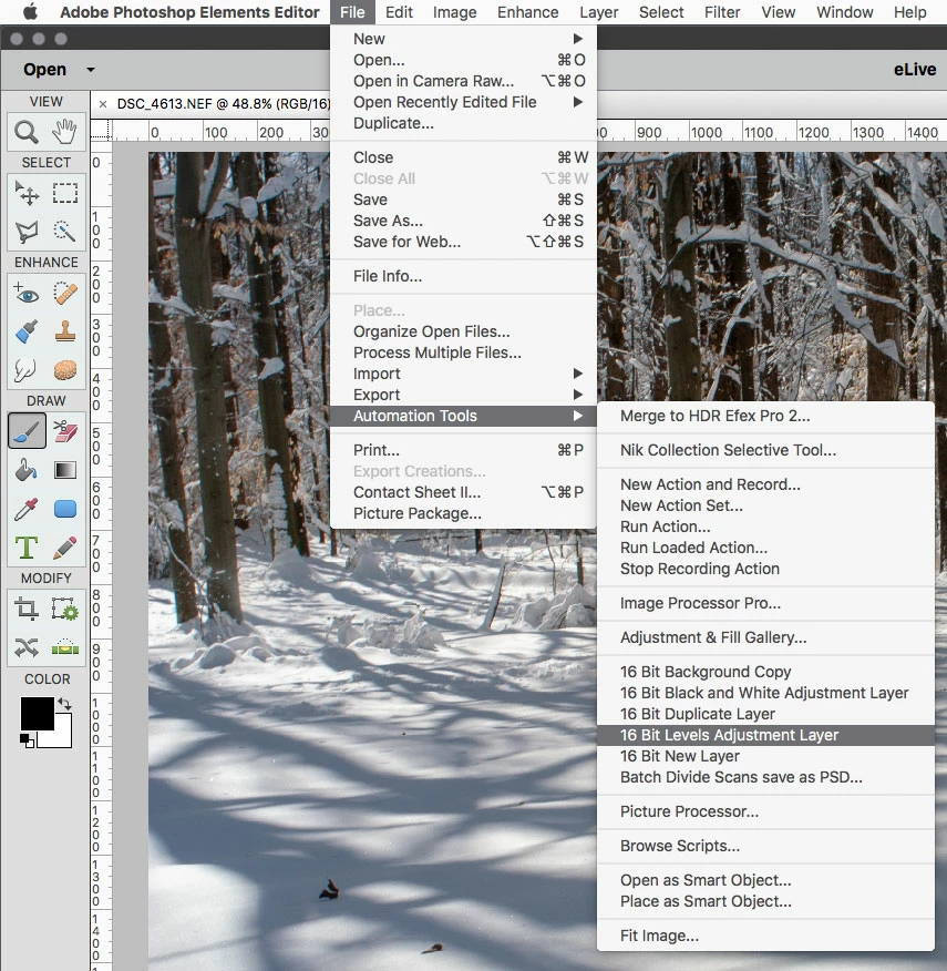

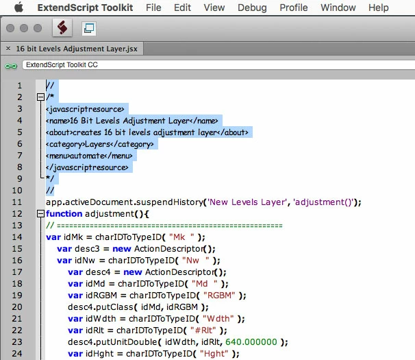

You need to add a javascriptresource to the top of the script so it shows in the Automation Tools menu.
You can use a text editor and make sure you save the script with a .jsx extension
An example where you put automate in the menu section
(automate will show on the Autmation Tools menu)
<javascriptresource>
<name>16 Bit Levels Adjustment Layer</name>
<about>creates 16 bit levels adjustment layer</about>
<category>Layers</category>
<menu>automate</menu>
</javascriptresource>
