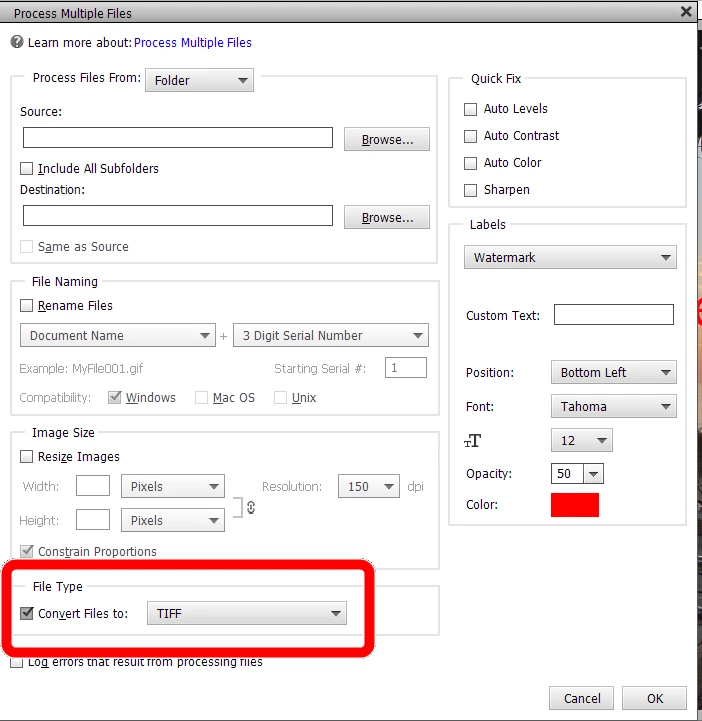

. . .  and in case you are not familiar with it, in the Elements Editor, you can use the File>Process Multiple Files menu command to convert the files in batches.

Thanks, that is what I have been using.
It is interesting that when I used Adobe Bridge 2022 for batch conversions for sets containing over a hundred files, it crashed each time, just after four sets. where else the batch conversion in Photoshop Element carried on fine.
