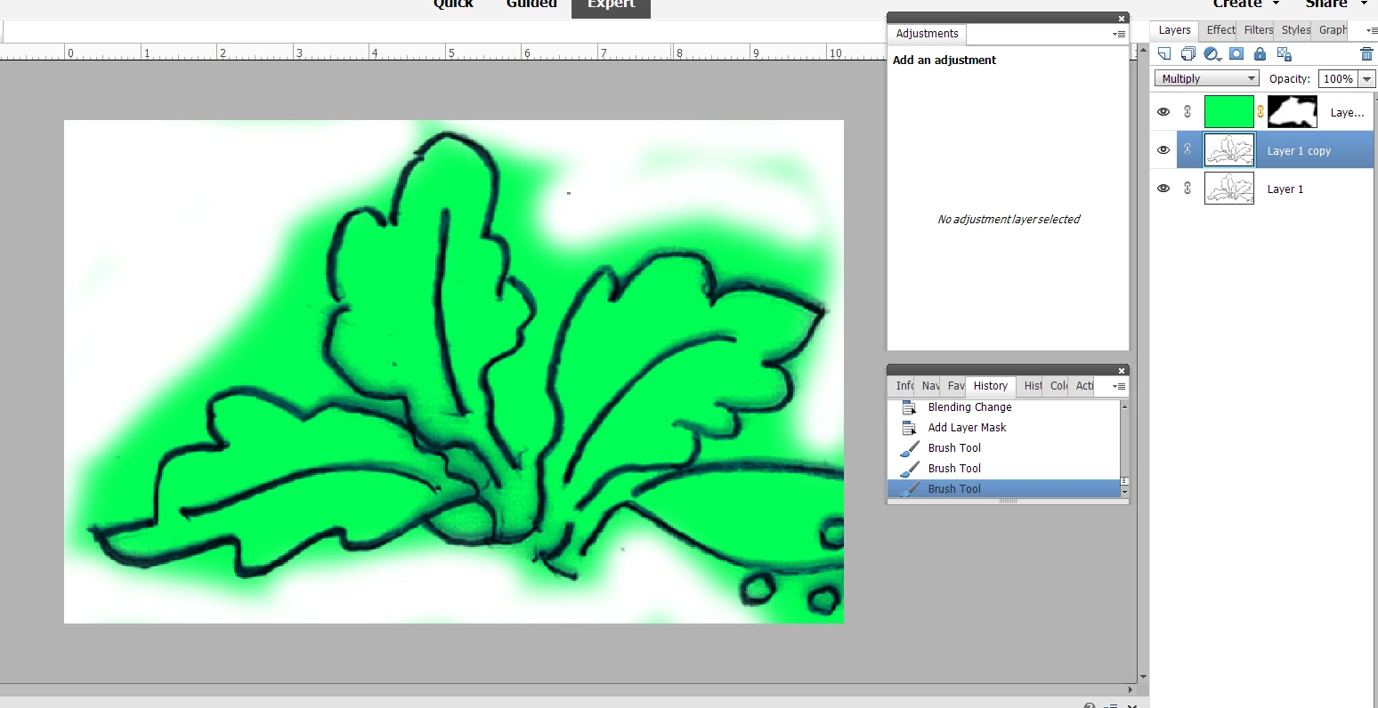

Your drawing is very difficult to use a selection tool because the drawing has a lot of contiguous space in it. So most of the selection tools will not work well with it.  In the following example:
  • I have copied the leaf layer and used a Multiply blend mode to darken the line drawing.  (Your image is also very low resolution, so will be pixelated.)
  • I have then added a Solid Color fill layer with the green and used a Darken blend mode.
  • Finally, I have removed the outside of the leaf with a layer mask.  Since, I have no artistic ability whatsoever, I have not tried to complete the mask with what you may envision for the color area.
There are probably many other ways to achieve your goals, such as using a lasso selection tool.  But I don't think any will be very easy.

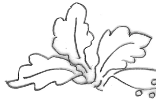

Thanks for the reply. Your idea is basically what I did that I didn't like... see the pixelization near the veins in your drawing?
I thought there was a Blending Mode, like Multiply, that could add a color without covering up the pixels that were already there?
I've atached a sample of the drawing, per your request.

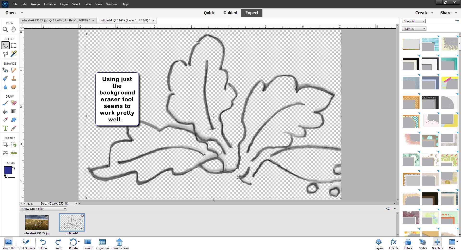

December 1, 2021
I would copy that leaf drawing- erase the background... when done coloring it in- just past the pencil drawing layer on top of what you just colored.
