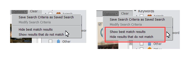

Greg_S.Correct answer
May 4, 2024 6:50 AM UTC
I now realize that the Options panel is very confusing.   The two choices shown in my earlier screenshot are actually the reverse of what needs to be displayed.  The two options are toggles.  If you click on them and end up with the setting on the right in the following screenshot, you should end up with only the untagged Year images displayed.

Greg_S.
Greg_S.Community ExpertCorrect answer
WKKruskeAuthor
May 4, 2024 2:13 PM UTC
Greg,  You are a genius!  I would have never guessed it was a two-step process.  I hope Adobe is monitoring this forum and learning from their subscribers.  And making their software more intuitive!

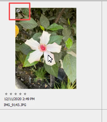

May 2, 2024 4:06 PM UTC
It works for me.  Can you show us a screenshot of your tag hierarchy with the Year tag showing.  And also show a screenshot of the Options dialog.  The photos without the Year tag will have a prohibition icon in the top left corner of the thumbnail.
WKKruskeAuthor
May 2, 2024 9:11 PM UTC
I see that icon now.  I wasn't sure what to look for.  I rather expected to see just the photos that were missing the tag to just show up. Now I know!  But the bottom line is, I still have to drill through 19K of thumbnails to find them.  Guess I have my work cut out for me!  Thanks for your help!

May 1, 2024 10:42 PM UTC
OK.    I think I have an easy solution for you.
  • Click on the Year tag to select all photos with that tag
  • Under Options, select Show results that do not match
WKKruskeAuthor
May 2, 2024 2:35 PM UTC
While promising, that feature does not reveal any useful results.  I select the "year" tag, and PSE shows 19,251.  I then select "show results that do not match" and PSE shows 19,301, the size of the entire catalog.  I tested it on other tags and the results are the same.  It always shows the entire catalog.  Hmm.
