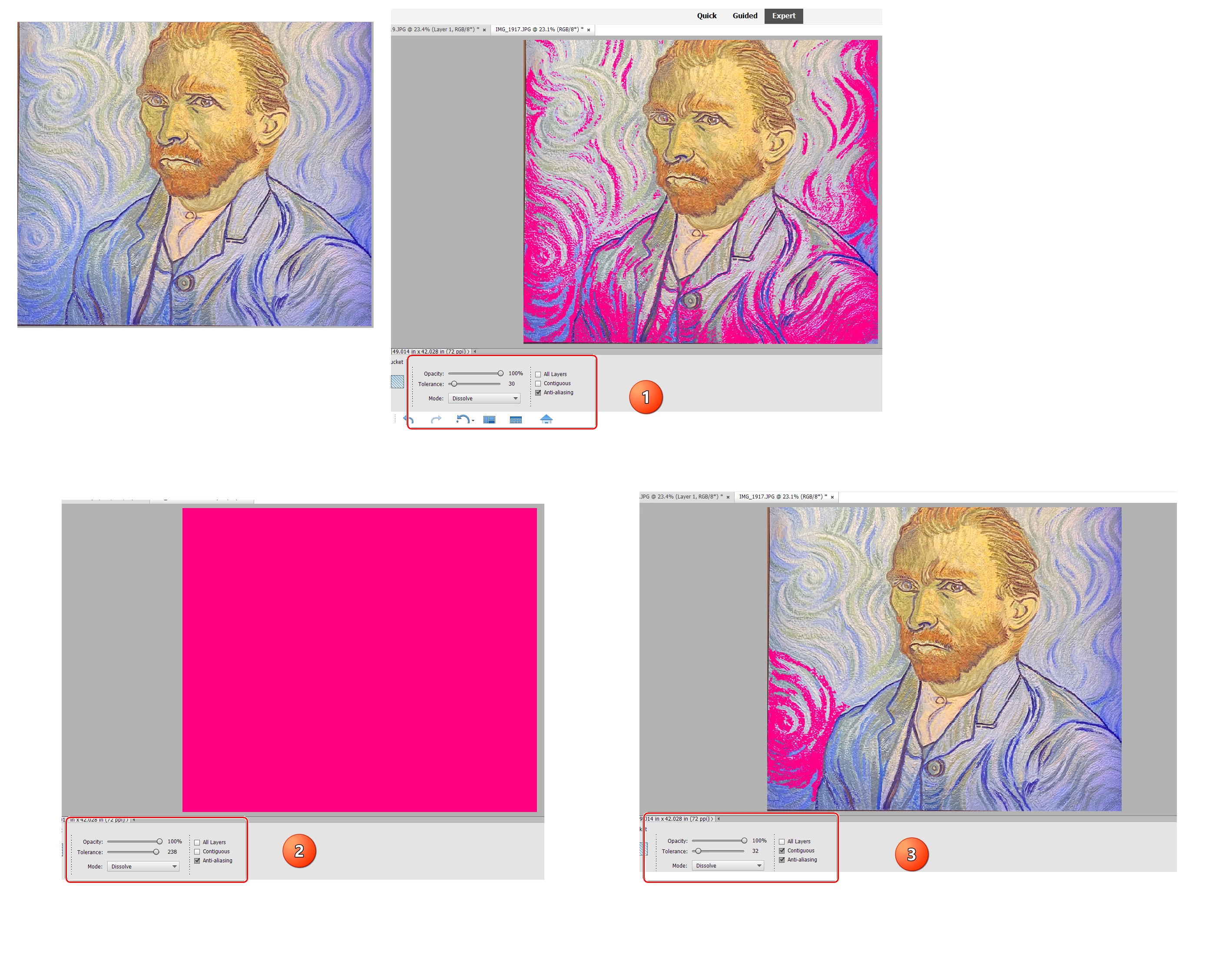

And just to emphasize the difference the tolerance slider can make, see the following screenshots:
  1. Low tolerance - non contiguous
  2. Maximum tolerance - non contiguous.  (It is the same with the contiguous box checked)
  3. Low tolerance - contiguous
