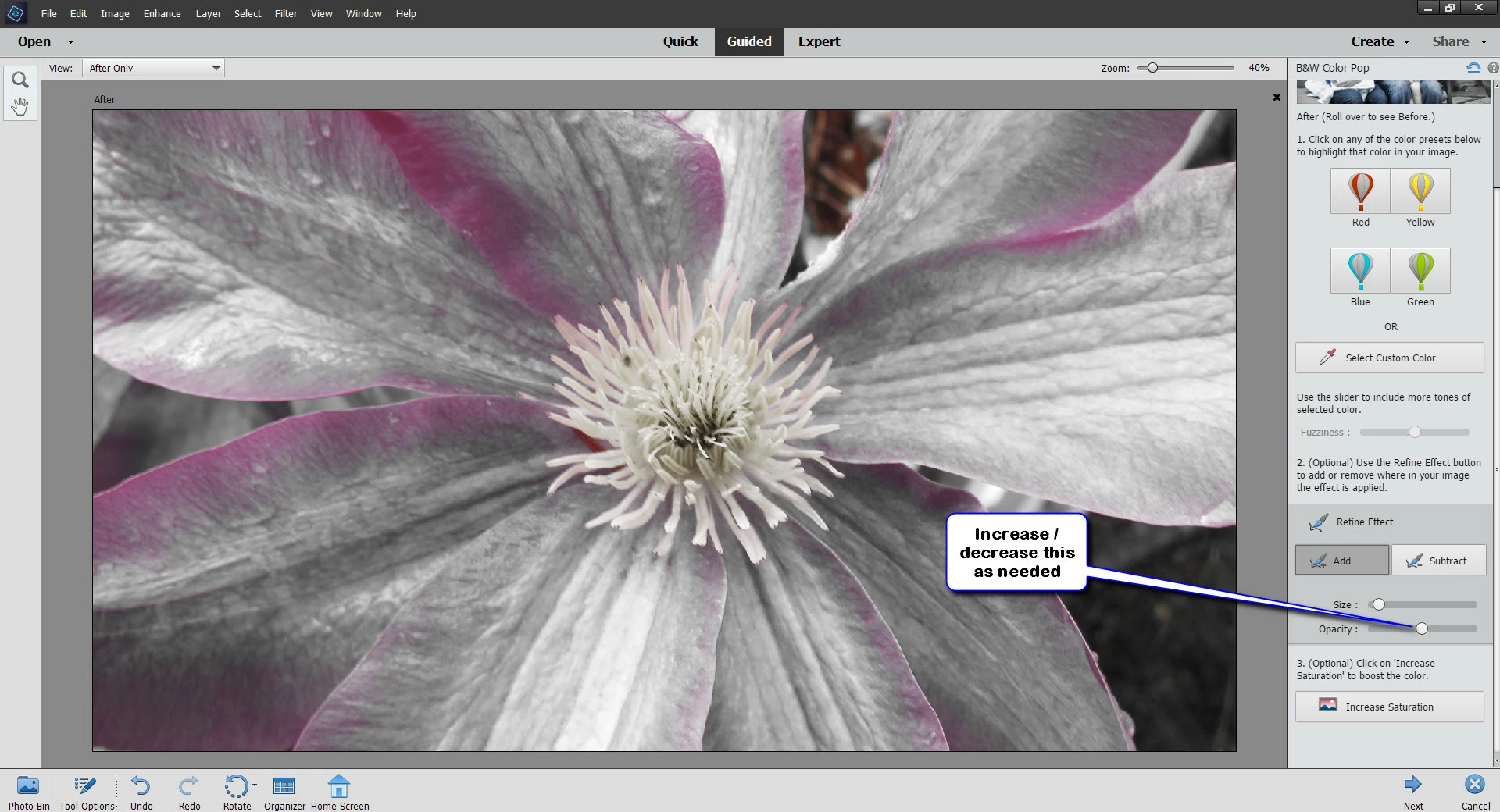

Most of the time it's due to the brushes opacity setting- see he image below...
July 11, 2021
Yeah I have tried that. The detailed brush doesn’t have a opacity setting in guided for black and white selection. The detailed brush is 1-2 tones lighter than main selection brush
