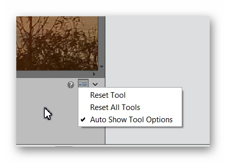

If this doesn't solve your problem, try resetting the Text tool by selecting the tool, and then going to the "hamburger" menu dropdown on the right hand side of the Tool Options panel at the bottom of the screen and select "Reset Tool."

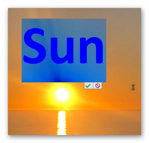

All you need do is double-click on the name you want to edit.  The text should then be highlighted like this:
 You can then replace the highlighted text by starting to type the correct name immediately.  Or, before you do that, click inside the highlighted area and a text cursor will appear, like this:
You can then use the arrow keys to place the cursor in the correct position, or use other normal text entry keys such as delete and backspace to edit and enter text.
You may need to zoom in to the text area to see the cursor, depending on the size of the font and the image.
Once you are done, click the green checkmark to save the edit.
